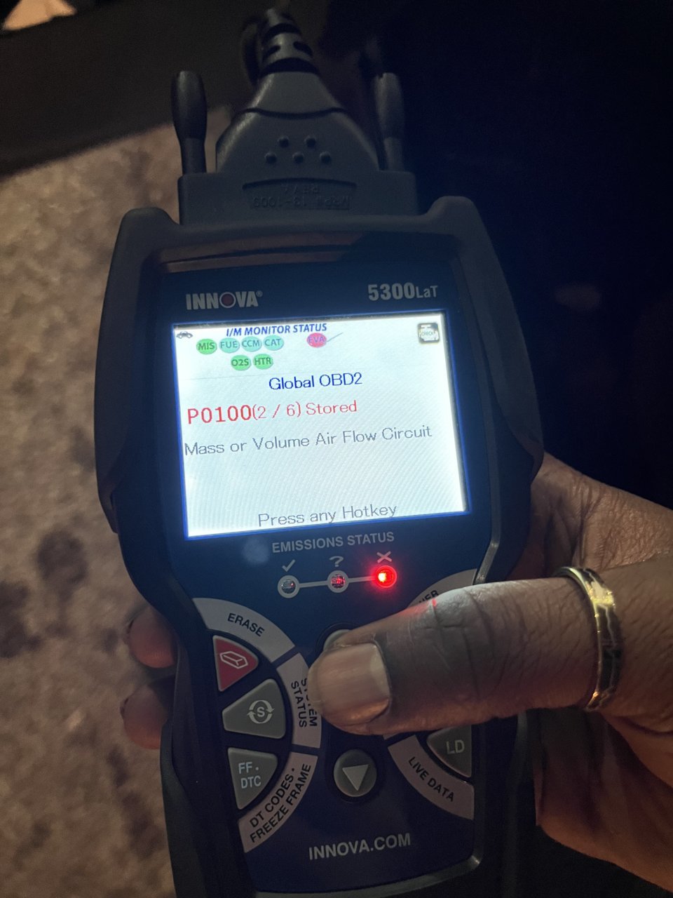

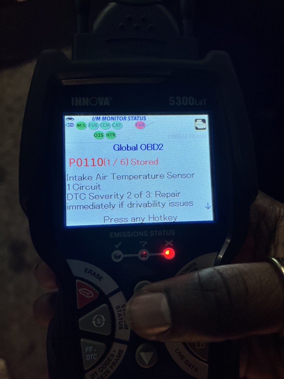

    Hey guys, CEL came on earlier and got some pics of the codes it threw. Recently changed out the valve cover gasket and pcv valve. OK to continue to drive? Any help is much appreciated.

    You need to fix the p01xx codes.
    With put proper air flow metering the engine isn’t going to run correctly.
    What is your IAT at?

    Check for sensors unplugged or loose intake hoses. Also check the connectors on the throttle body to see if they’re plugged in.
    if everything checks out, could you have possible turned the ignition on before plugging the sensors back in? If so, clear the codes and recheck.
