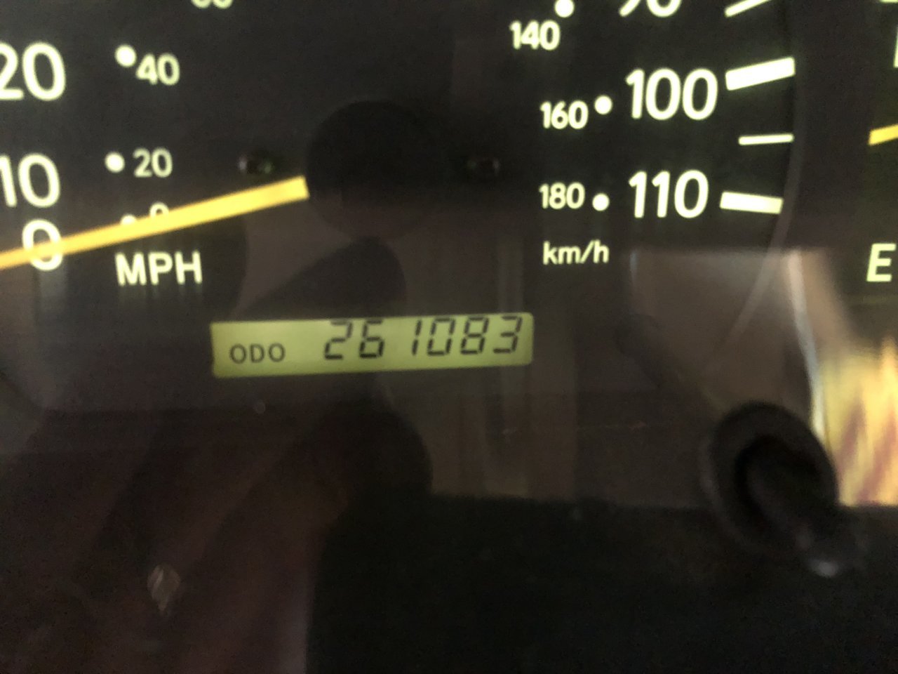

    Yes I replaced the bulbs . And I tried 2 different gauge clusters . I also checked all of my fuses. I think I have a wiring issue ....??? Does anybody have or have had this problem before ? None of the Accessory lights are lighting up around the fuel gauge . The back light bulb works . And the gas gauge but that’s it .

    No lighting up at all . 1st click ... 2nd click either . I have swapped out flipped around . None of those lights light up no matter what ...
