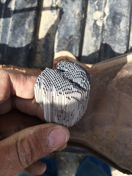

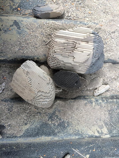

    Nope. Check engine light for like maybe a day. The failure came on real quick. The part that I noticed anyways. My only indication I had a problem was my truck got low on power, and had a bad exhaust leak right off the manifold, where the exhaust pipe meets up. I use my truck exclusively for work on rough gravel and muddy roads. Like washboard rough in spots. I think the catalytic converter failed from vibrations. Like turned to powder and plugged up. 1st pic is some of the powder from the cat when I was trying to figure out why my exhaust doughnut was blown out.

    Looks like the cat overheated? An exhaust leak might cause the O2 sensors to falsely read a lean condition and cause the ECM to richen the mixture. After a while the excess unburned fuel could cause the cat to overheat and eventually disintegrate. Not sure about this, just hypothesizing.
