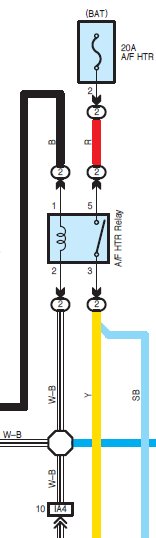

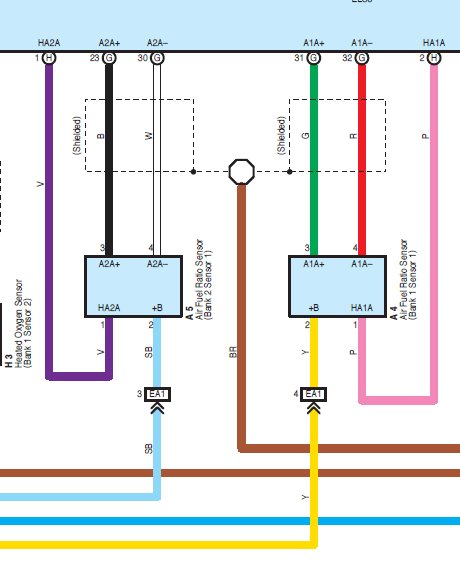

    Seems like Brian has the best answer, if I were to guess. (and also check the 20 amp fuse feeding that relay, fuse appears to ONLY feeds the A/F sensors it appears.)

    Thanks to BigWhiteTRD for putting up the schematic and mentioning the fuse in the circuit.
