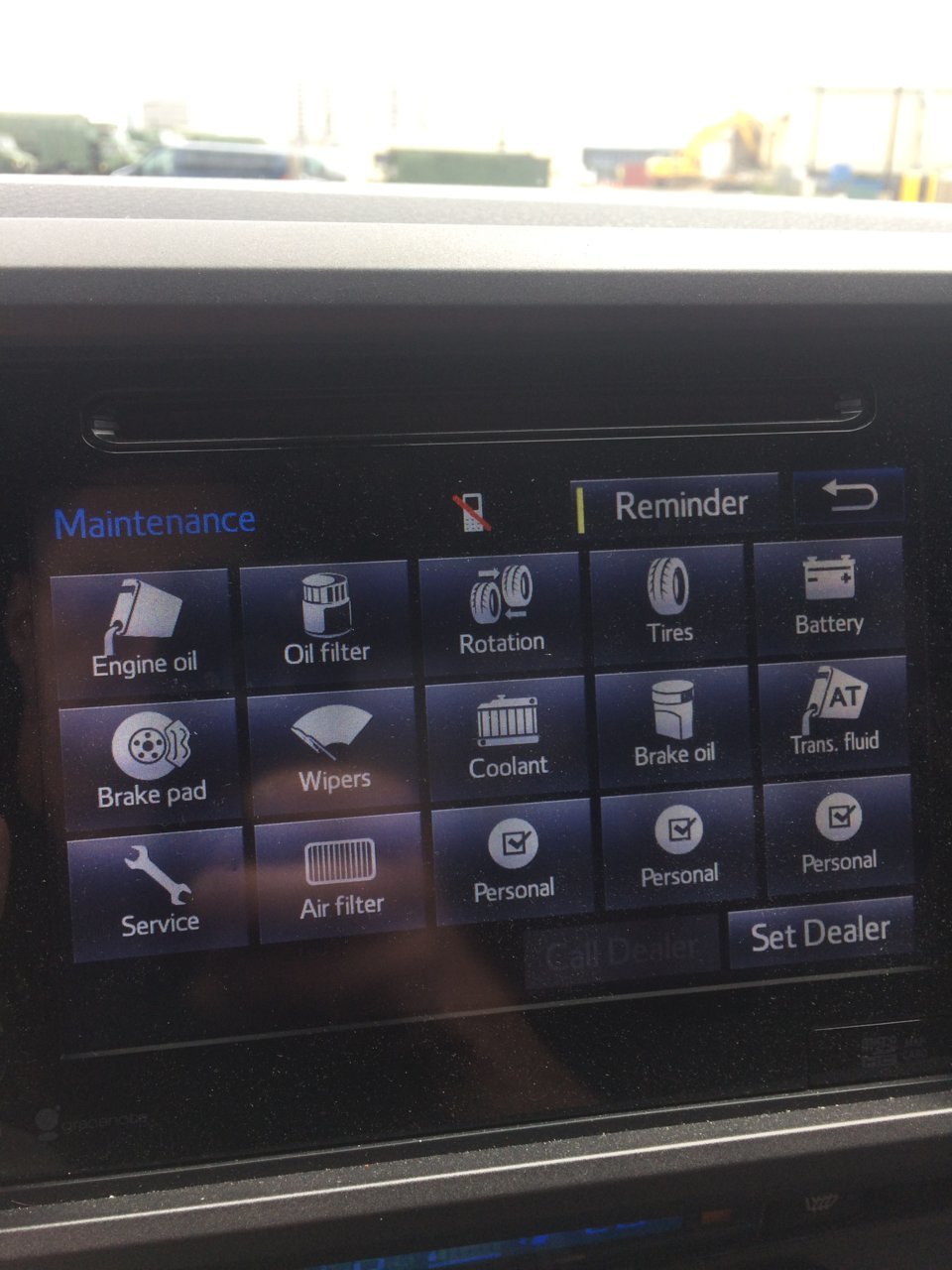

    Um, what note is there for " *10 " on that page?
    It seems like some people on here are thinking that the maintenance reminder can't be shut off for good. I haven't had any set up in my head unit since I bought my truck, so that amber triangle never comes on.
    Maybe I am misunderstanding this conversation though... :notsure:
    Edit: If any of these icons are orange, there's a maintenance item set up. There's also an option to delete all.
    My truck doesn't see the dealer at intervals less than 10K miles, and I've never seen the reminder light.
