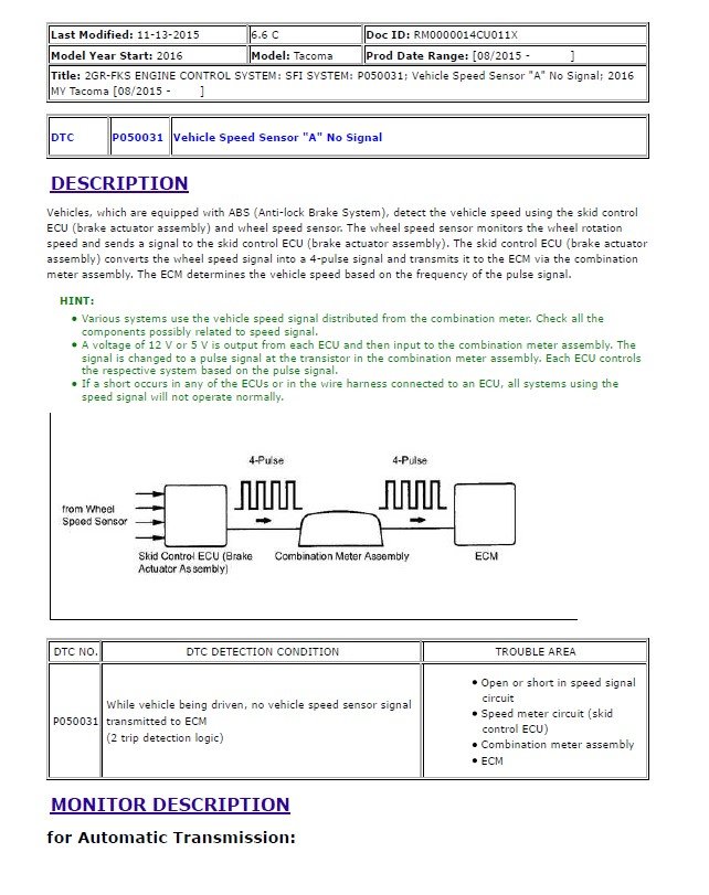

  18. Oct 8, 2018 at 7:23 AM
    #58
    jsinnard
    jsinnard Well-Known Member
    Feb 4, 2009
    #13279
    6,679
    J
    Virginia
    16 QS DCLB OR 4X4
    If it's the same code then they should consider changing out the speed sensor and do continuity checks of the sensor circuit. All they did last time according to your invoice was reset to see if it returned.
    P050031 does indicate a speed sensor not sending signal to the ECM.
    http://zatonevkredit.ru/repair_manuals/raw_content/RM1000000011G1L.xml
    If it's a different code that includes cascading faults then consider isolating the amp to see if it returns.

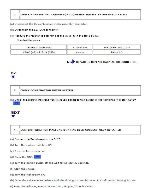

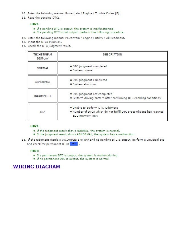

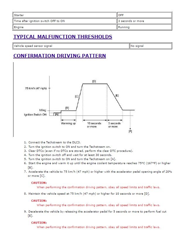

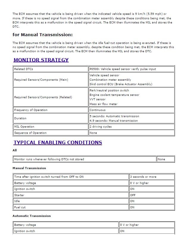

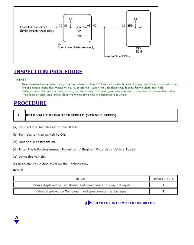

    From the 3G Tacoma service manual. Hell, I could easily use techstream (and my Tactrix cable) as described in the procedure to at least narrow it down.
    Speed sensor 1.jpg Speed sensor 2.jpg speed sensor 3.jpg speed sensor 4.jpg Speed sensor 5.jpg Speed sensor 6.jpg
    tonered, Saeros and jsinnard like this.
