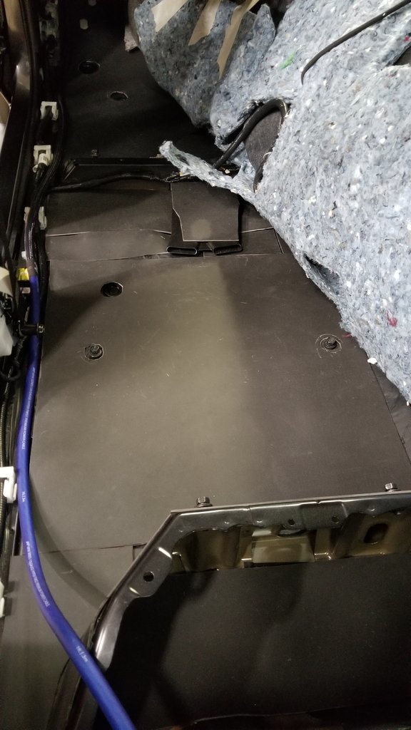

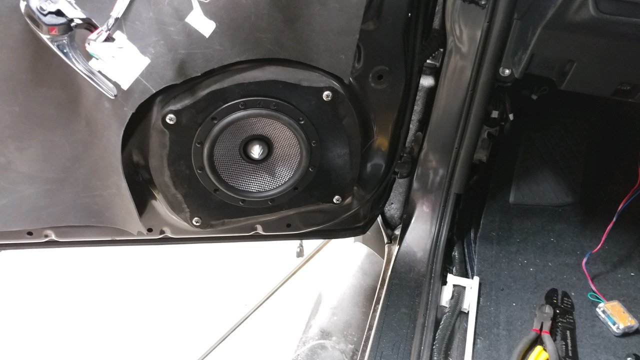

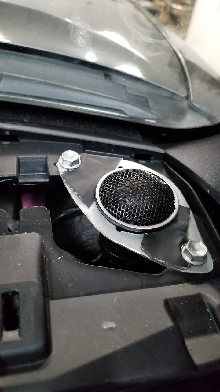

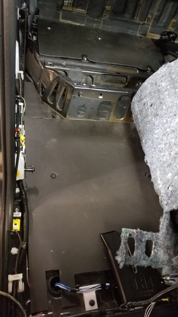

    Here's some pictures from my custom audio install. A friend and I did the work.
