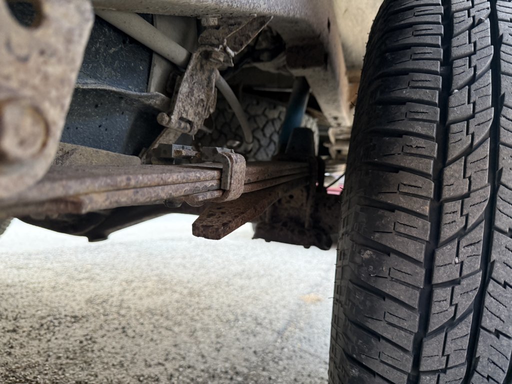

    Ok as I've been messing with it, that abs code could be unrelated and the issue could be axle wrap due to worn leave springs. I've come to this conclusion after driving it for the whole day with the same issue and no more lights on the dash. My leaf springs are perfectly FLAT under zero load. Would that contribute to my issue of skidding at the end of my stops? It happens especially when I am coming to a stop after being over 25mph and if I brake a normal amount without trying to feather it at the end, it will skid and feels like it coming from the back

    I wonder if the springs are so flat its triggering the load sensing valve into thinking there is a heavy load when there is none. Biasing the brake pressure towards the rear with no additional weight makes sense it would lock up the tires.
    I don't know why this would generate a code though...
