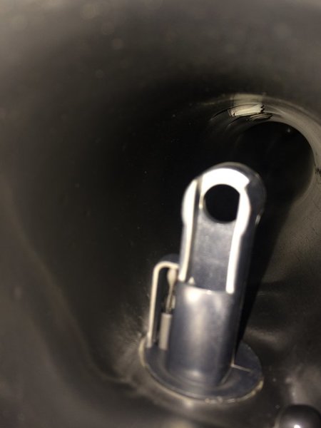

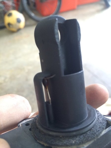

  9. Jun 23, 2015 at 11:21 AM
    Joey_bollasina
    Joey_bollasina [OP] Active Member
    Apr 30, 2015
    #154314
    27
    Joey
    2000 Tacoma Prerunner
    The Maf was fairly dirty, not sure how it should look, the second picture is after cleaning
  10. Jun 23, 2015 at 5:51 PM
    keakar
    keakar Well-Known Member
    Oct 2, 2014
    #139537
    5,258
    karl
    louisiana
    2006 4runner sport 4.7L V8 (white)
    used to have - 99 2.4L I4 5 lug & 04 prerunner v6
    you do know the main part that needs cleaning is the one deep down inside that tube?
    the thingy on the side is less critical if that is dirty but the main sensor is hard to see and not easy to clean down inside the tube
  11. Jun 23, 2015 at 5:57 PM
    Joey_bollasina
    Apr 30, 2015
    #154314
    27
    Joey
    I sprayed some in there as well
  12. Jun 23, 2015 at 9:33 PM
    Joey_bollasina
    Apr 30, 2015
    #154314
    27
    Joey
    I went and swapped my sensors, started and light stayed on, I then pulled both The Efi fuses and obd fuse, and turned the key on, after putting them back in and starting the light was still active, I pulled maf again and cleaned as you said down inside the tube and went to start and no light, I will drive and once the light comes back if it does soon I'll check it right away
  13. Jun 23, 2015 at 9:33 PM
    Joey_bollasina
    Apr 30, 2015
    #154314
    27
    Joey
    Note: I did not clear the codes
