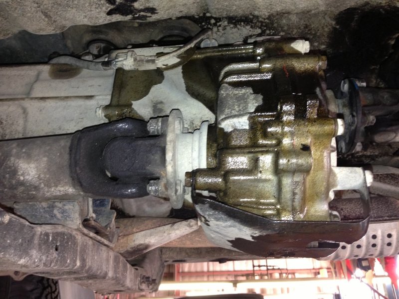

    image.jpg image.jpg I believe it's leaking from the top of the transfer case, but everything under there is covered in oil. It's leaking a lot, and definitely wasn't leaking before the clutch job. Pretty concerned about it as I can't get it back into the shop until Wednesday. Is there anyway that I can top it back up? I'm worried about it running low and stripping everything. The oil pool by my hand happened over the course of about 2.5 hours. It's leaking a lot.

    You can check at the fill plug .Although with out a pump it is a pain getting it in.
    It is possible they either over filled it and it is pushing out the breather
    Forget to tighten the bolts when the shifter was put back on.
    Not really hard to remove the console and the shifter boots and take a look .
    in any case hot gear oil a 1/2 a pint looks like a gallon!!

    most likely they didn't reapply the RTV on your transfer case shifter or they messed up the gasket under it. It's been a while since I pulled my T-case shifter when I put my clutch in. I think it might be a fiber gasket and in that case they most likely tore it when pulling your shifter. If you just had the clutch replaced look at the age on the RTV and condition of the gasket when you pull it off, or just take it back to them and be like,WTF Mate?
