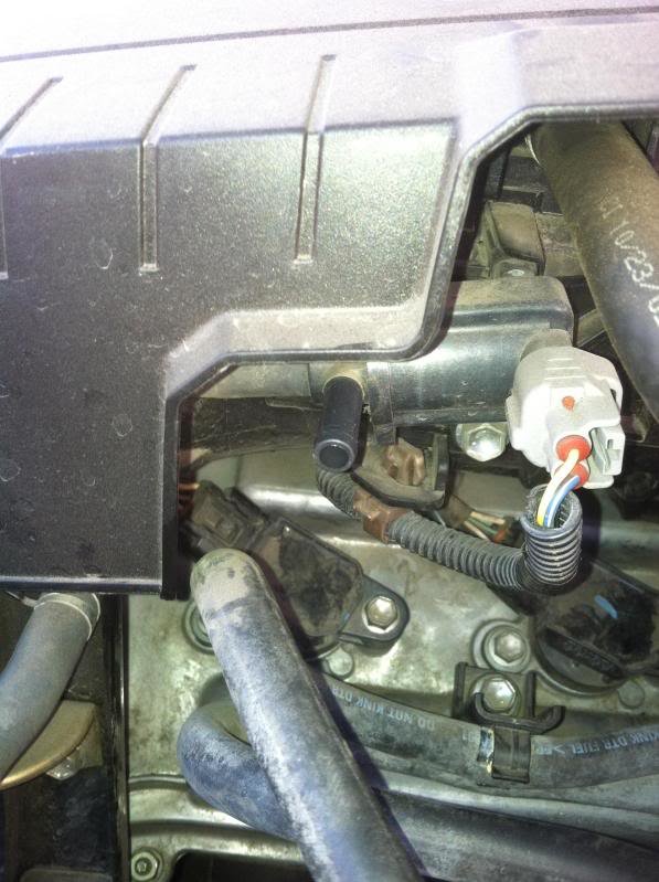

    i Only drove the truck 17 miles since the service. Today after a 3 day weekend i returned to work. and i notice an Engine light. I stopped and check my oil and it was fine. but i noticed a small air leak through a plastic intake tubing from my air intake cover. It Seems as if it had a 1/2 inch hose connected in there at one point but now is missing. i took a picture of it. any Idea what may be connected there whatever it was is no longer there.

    It should look like this:
    The hose being disconnected from the VSV would definitely throw a CEL.

    Looks like the clamp might be missing from the hose. Take it back in and have them hook it up, test it, and clear the code. The tech forgot to hook it back in and they need to take care of that.

    Thankyou that picture helpme find the disconnected filter like hose. but how do i clear the engine light now? should i take it back to toyota?

    cool i think i can live with it for a few days.. thanks
    it was driving like shit with that valve off... once i connected it it felt fine.
