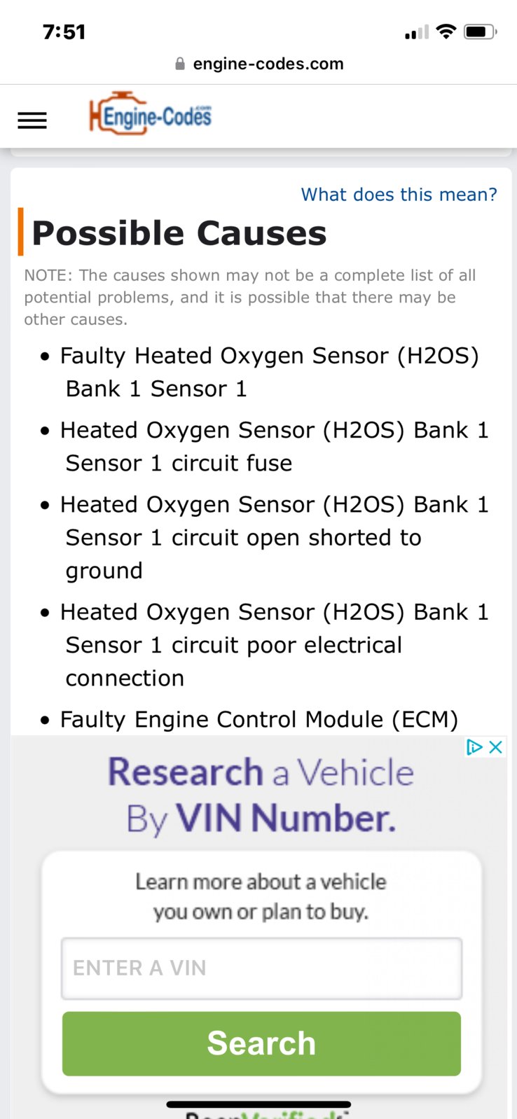

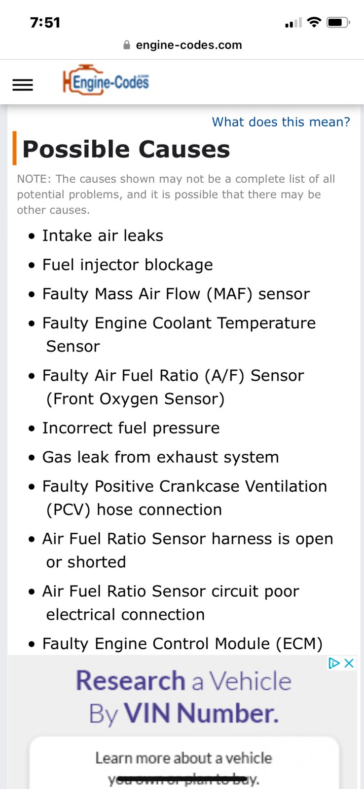

  10. May 18, 2024 at 5:54 PM
    ControlCar
    ControlCar My Moto: Help & Learn…period.
    Jul 22, 2023
    #429578
    3,617
    Steven
    Sugar Land TX
    1996 Taco 2.4L 2wd Automatic
    Clock Volt meter/LSPV Delete/Hyundai 16’s/FP gauge/after 9months of wrenching ZERO oil leaks
  11. May 18, 2024 at 5:55 PM
    ControlCar
    Jul 22, 2023
    #429578
    3,617
    Steven
    Sugar Land TX
  12. May 18, 2024 at 5:57 PM
    ControlCar
    Jul 22, 2023
    #429578
    3,617
    Steven
    Sugar Land TX
    From the data
    Would say start with front O2 sensor
    (Shows up 3 times in poss reasons for CE light)
    this is guess unless you bench test the sensor or listen to TN shooter
