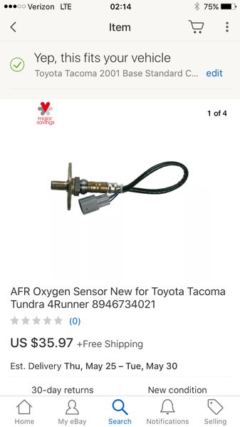

    They quoted you the Bosch one didn't they ? Autozone quoted me the Bosch one lol $100.00. No thanks, came home went straight to EBay And found this one

    I got a toyota OEM one on Amazon for about $100...it was awhile ago, I don't quite remember. I try to stick to OEM being that I'm planning on keeping my truck until at least 2030. I'm sure the other brands are okay. But, the OEM one lasted 200,000 miles with no issues. I'm okay with spending a little more money on proven parts.

    Do you happen to know the two actual codes from when they scanned your ECU? Also, when changing out O2 sensors or AFR sensor, Yotas can be pretty picky about which brands are used on their electronically controlled systems. You probably only want to source Denso brand(who makes the OEM sensor for Toyota) or if you enjoy paying the Yota mark up on parts, any dealer or online parts dealer.
