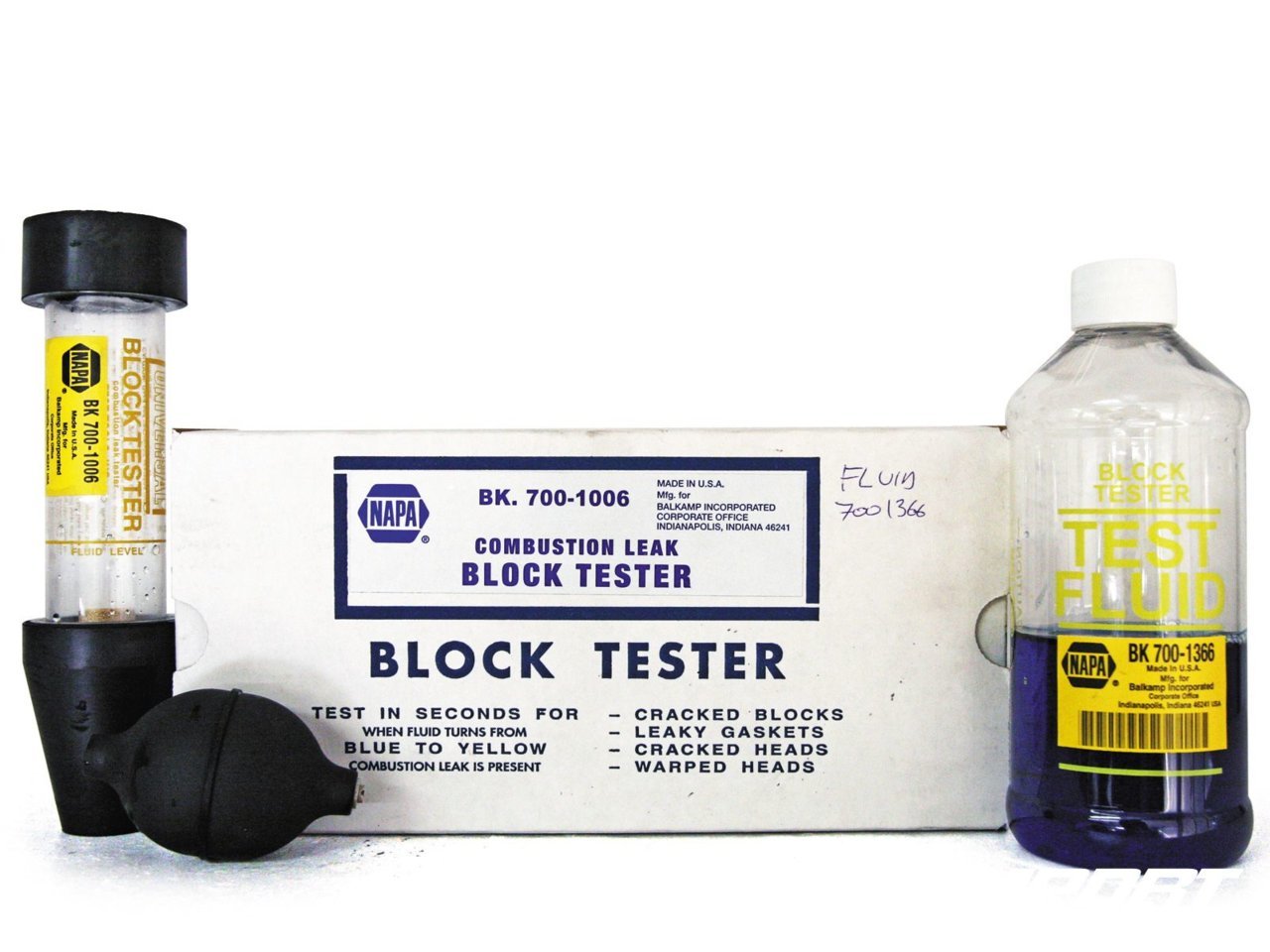

    impp-1107-12-z+blown-head-gasket-diagnostic+block-tester.jpg-1.jpg If you are slowly losing coolant check area below water pump closely for red/pink crust (evidence of a slow leak). Also check all coolant hoses/connections, look at the radiator closely.
    If you aren't seeing any external leaks and you have to add coolant on a regular basis then the headgaskets are a concern. The coolant has to be going somewhere
    Use a block tester kit
