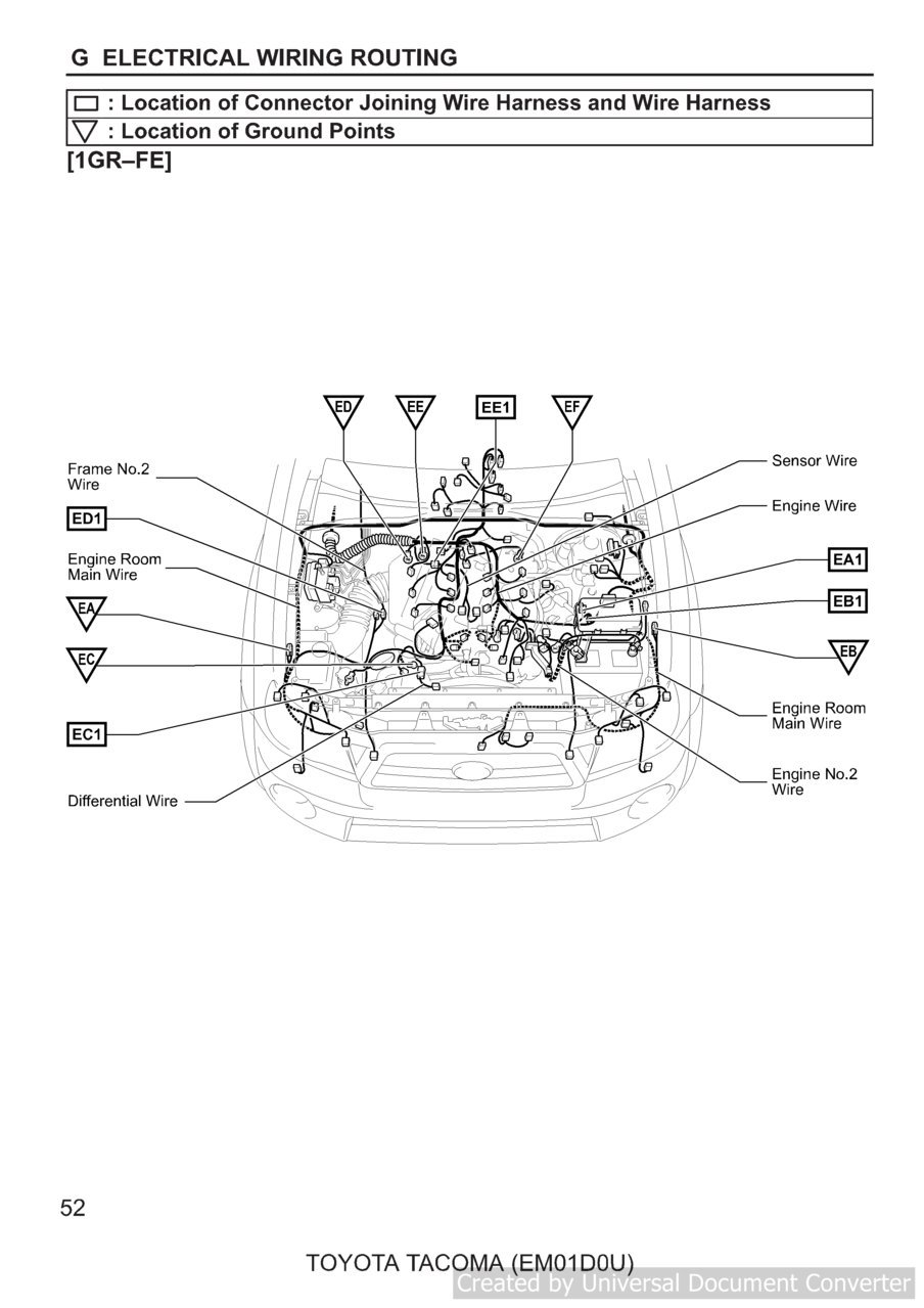

  13. Aug 28, 2022 at 9:54 AM
    Dm93
    Dm93 Test Don't Guess
    Mar 3, 2015
    #150066
    13,915
    Texas
    2014 DC OR 6spd 4x4
    Predator tube steps, Ranch Hand grill guard, Magnaflow CatBack exhaust, Toyota tool box & bed mat, 2LO Module by @Up2NoGood, Rearview Compass/Temp Mirror, Tune by @JustDSM.
    Those are all o2 heater codes, the chance of them all failing at once is very slim.
    Having all those codes as well as a MAF code and an intermittent stalling problem all at the same time makes me think you may have a main power or ground problem.
    I think I'd start with inspecting the main grounds in the engine compartment.
