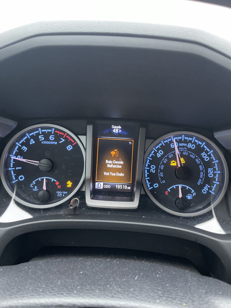

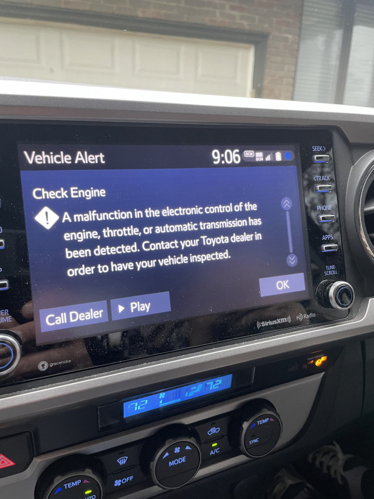

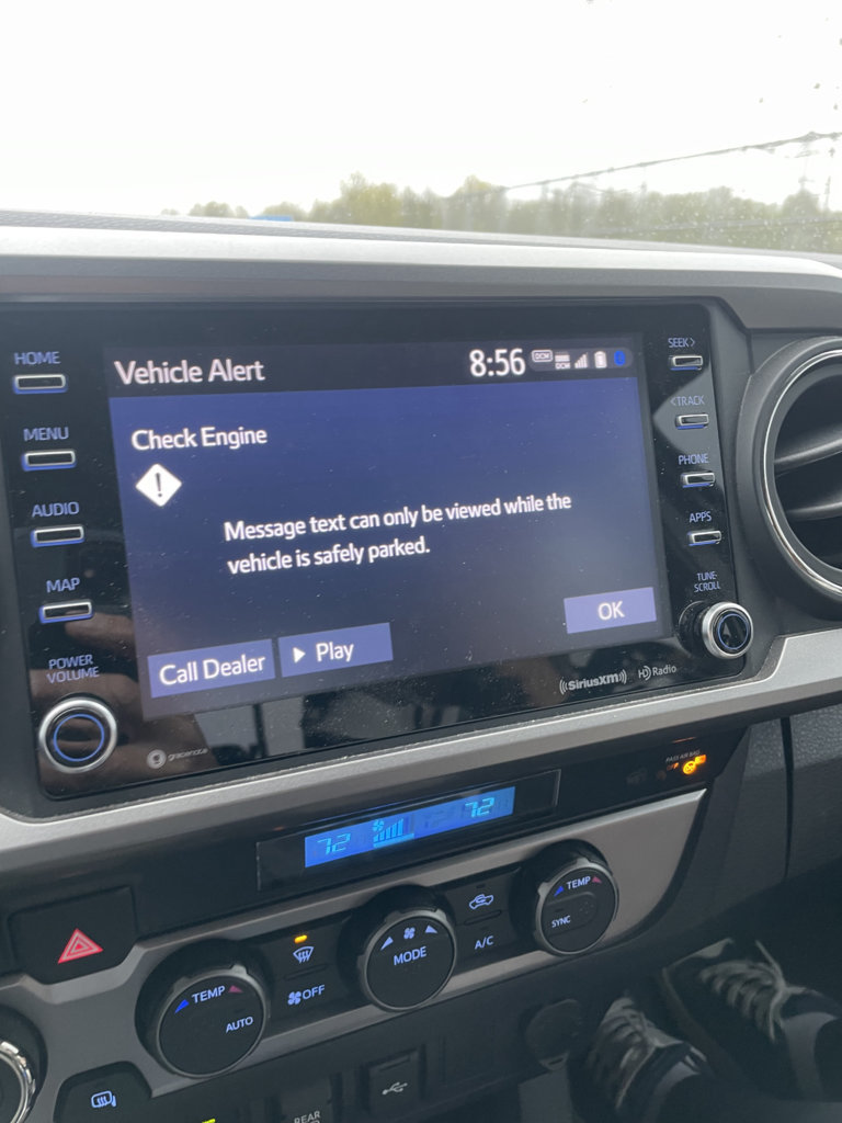

    Today, I left my truck idling for about 5 minutes while I ran into the store. When I came back out, the check engine light was on, along with a message saying: "A malfunction in the electronic control of the engine, transmission, or throttle has been detected."
    I’m wondering—has anyone else experienced this issue? If so, what was the cause?
    I do have a Pedal Commander installed, but I’ve already unplugged it and the check engine light is still on.

    I never was given a code from Autozone, but I unplugged my Pedal Commander and everything is fine now.

    I had the same message right after I installed my Sprint Booster but it was while I was driving on the highway, in traffic, and it went into limp mode, not a pleasant experience. I never unplugged it and everything cleared up after a couple start and shut down cycles and about 50 miles. It's been about 2500+ miles since that happened and so far so good . I wonder if there's a learning curve for the ECM or if it was something all together non related. Whatever it was, it lingers, in the back of my mind, wondering if or when it's going to happen again. Never had it scanned to reveal what codes were thrown.
  14. Jun 19, 2025 at 6:15 PM
    Vlady
    Vlady Well-Known Member
    Dec 20, 2017
    #238986
    4,516
    Issy, WA
    2017 White SR5 DCSB V6 4x4
    The system sensed a signal disagreement in electronic throttle control.
    It will happen again. Get rid of it
