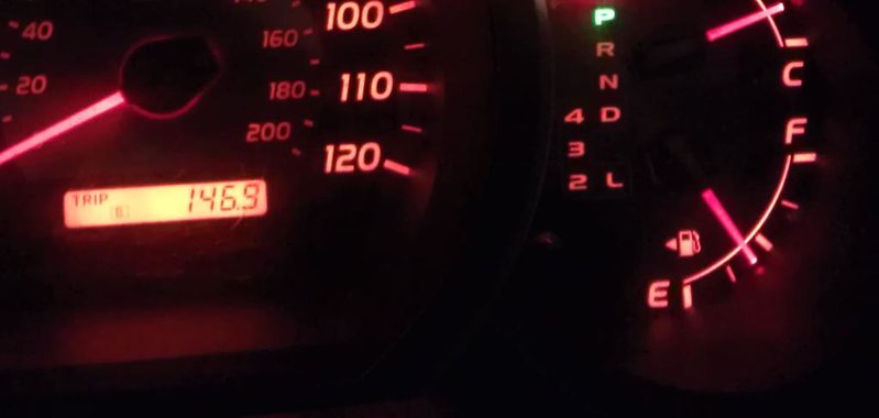

    diag says cylinder 6 not firing, just tested coil and new iridium plug both good, but since light come on i got....
    (see pic)
    this is not a hard I-10 run, this is just from smaller state roads like running at 45-65mph
    (drinking gas!)
    i restart trip odometer every fill up....
