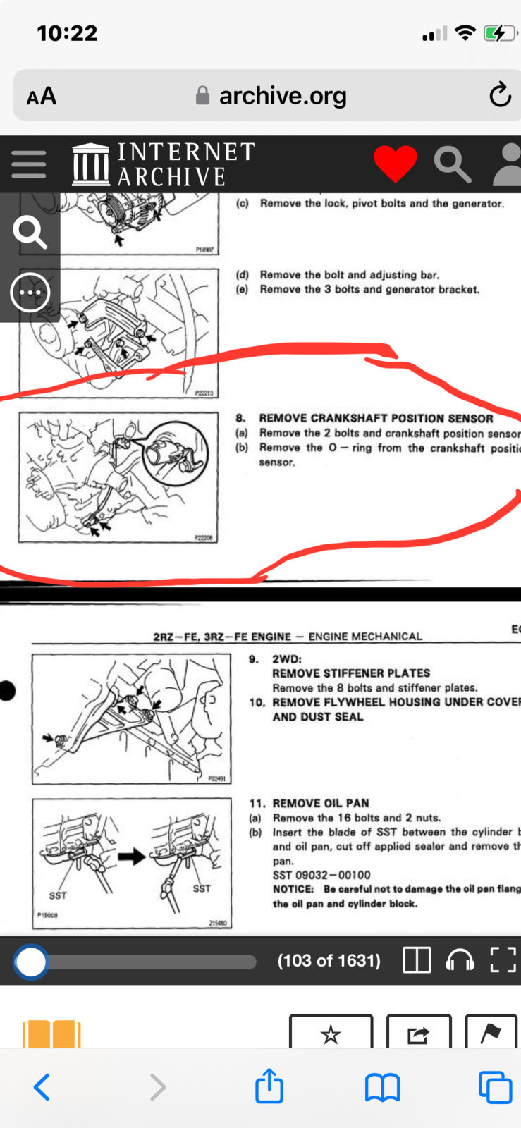

    Driver’s side of engine
    To the front
    Under the cooling thermostat housing
    if u promise to post your results, I will take a pix for you man!
    JK
    Let open garage and get flashlight……

    Clock Volt meter/LSPV Delete/Hyundai 16’s/FP gauge/after 9months of wrenching ZERO oil leaks
    IMG_4171.jpg Here u go

    Dang pix mixed up….not in order from far away to close

    That's the crankshaft shaft sensor. Not the camshaft

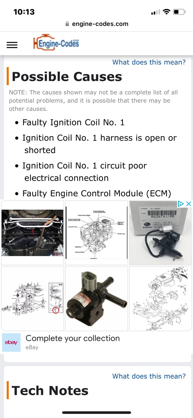

    I will keep me F*** up post/pix there so everyone knows I make mistakes
    Ugh

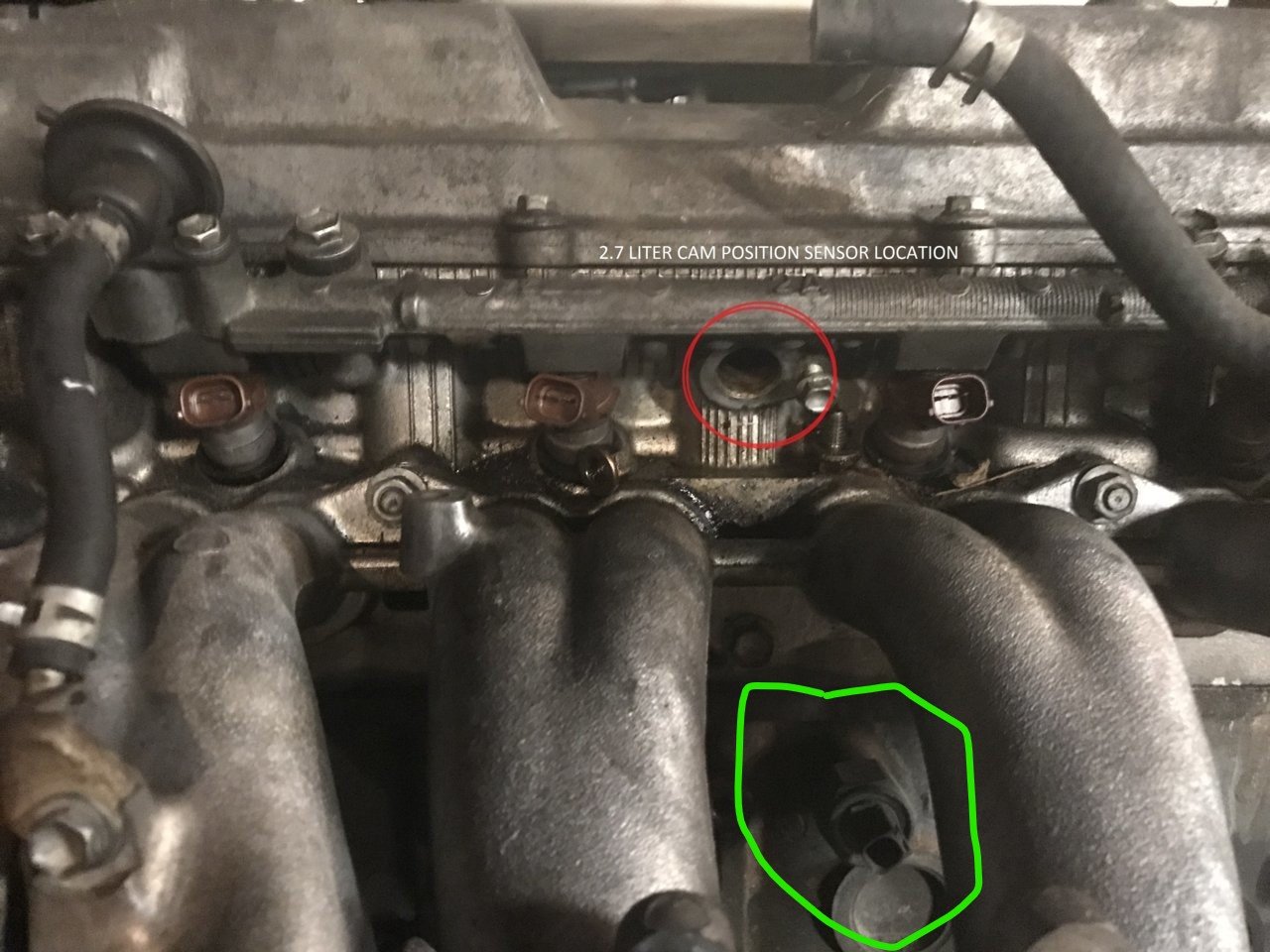

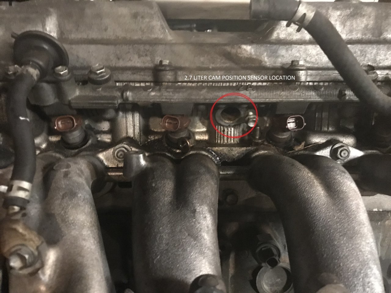

    If you have coil packs or coil overs this is where your cam sensor is....
    right inbetween injectors 2 and 3.....in the actual head
    Kinda pia to get to.......inside the intake manifold cave.....

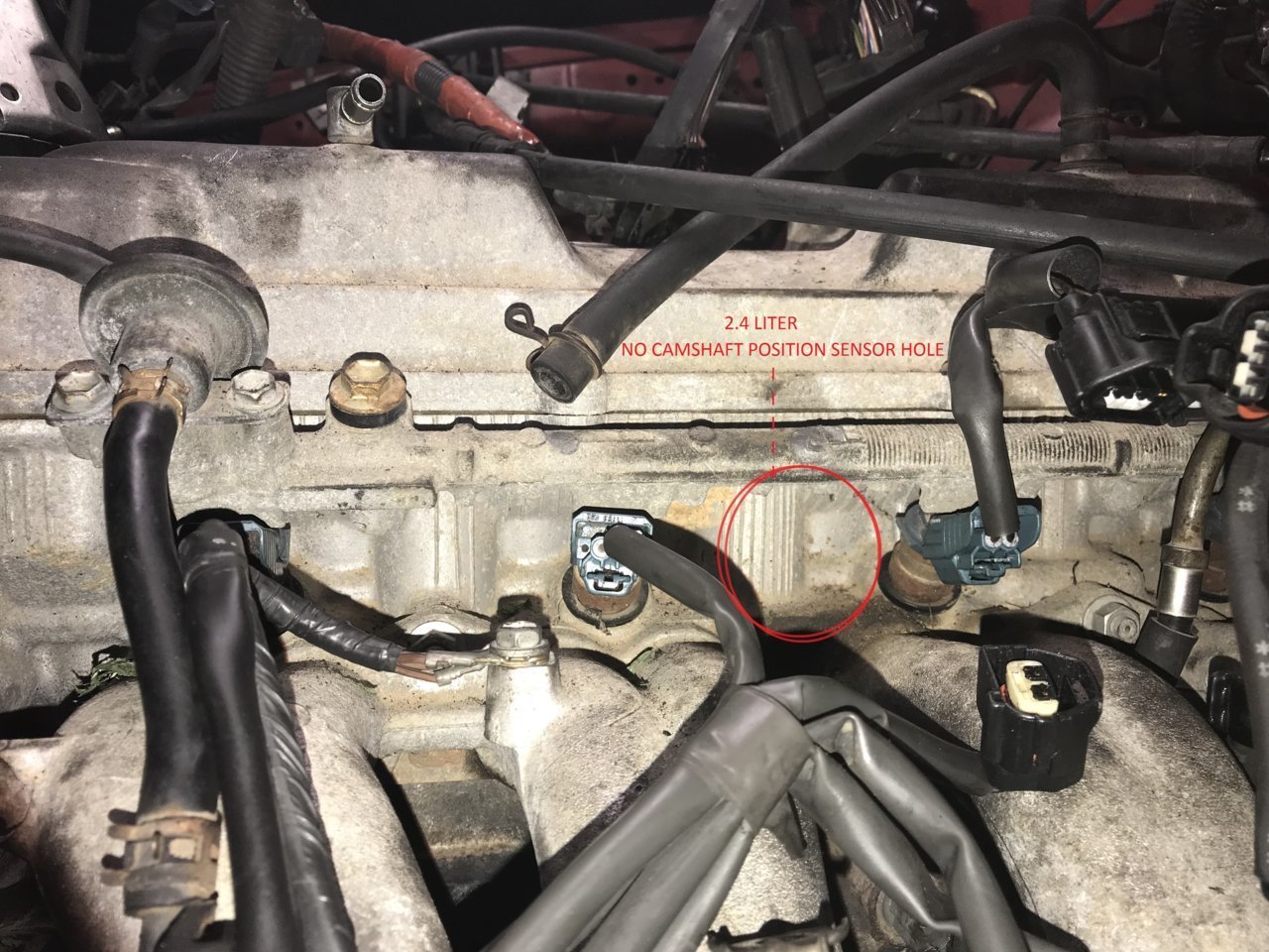

    If you have a points distributor.....

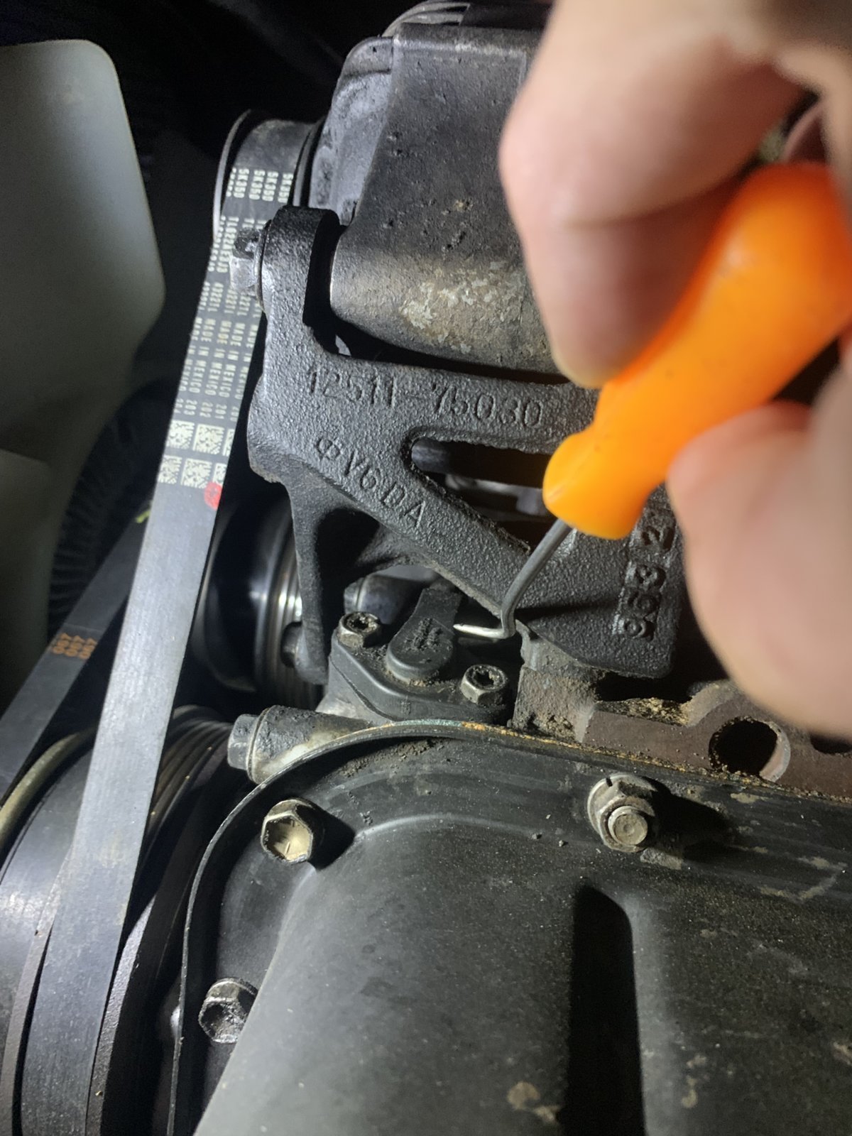

    Crankshaft sensor is under the alternator mount.....so you do the math....
    it only takes 2 hours to get to those 2 bolts......first time anyways.....
