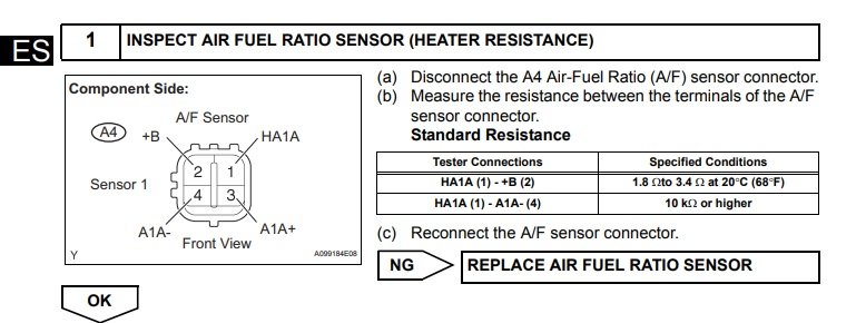

    The upstream sensor is an AFR sensor.
    P0031 means the PCM is seeing less than 0.8 amps of current on the AFR heater circuit.
    You can unplug the AFR sensor and check the heater circuit resistance (pins 1 and 2), it should be 1.8-3.4 ohms cold
    Denso is the OE AFR and O2 sensor manufacturer, make sure you get one from a reputable place (alot of fake parts on Amazon and Ebay) and it's the correct part number.

    Finally got around to testing the resistance of the sensor. I could not get an ohm reading between any of the pins. Pretty sure its not my meter was able to get an ohm reading on a small piece of trailer wire. Tried a continuity test between all the pins an meter wouldnt beep. Going to go ahead and replace the sensor which was the plan anyways. But good to test and not just fire parts at it.
