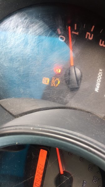

    Hi my check engine light came on and it was my gas cap. I went and got it checked and want to know how to reset it. But mainly I was wondering about the second light. In the first picture I turned my traction control off and then the second one I turned it on. I'm wondering why this other "car swerving" light is on? As this happened to anyone else's truck?

    It is constantly on, and I'm pretty sure it comes on when your tires spin out.

    If you push your traction control button it only turns it partially off and if you hold your traction control button it turns it fully off RTFM so your swerving car means you can smoke your back tires off now and the other one means your doors are open.

    Your traction control light comes on when the check engine light comes on. If it doesn't go away when the light is cleared you have a problem with the traction control system. Pull codes

    Ohhhh okay, thank you guys I will testing this out to see how it goes!

    The traction controlsystem is just saying that it is aware of an issue on the check engine light side of things.. when the CEL gets cleared (manually or goes away on its own) the TCS light (s) will go away too..
    If you're certain youleft the cap loose, justgo to oreilly's and ask them to clear it.. or if enough drive cycles occur without seeing the same fault will clear itself.. it may take a week or 2 tho..
