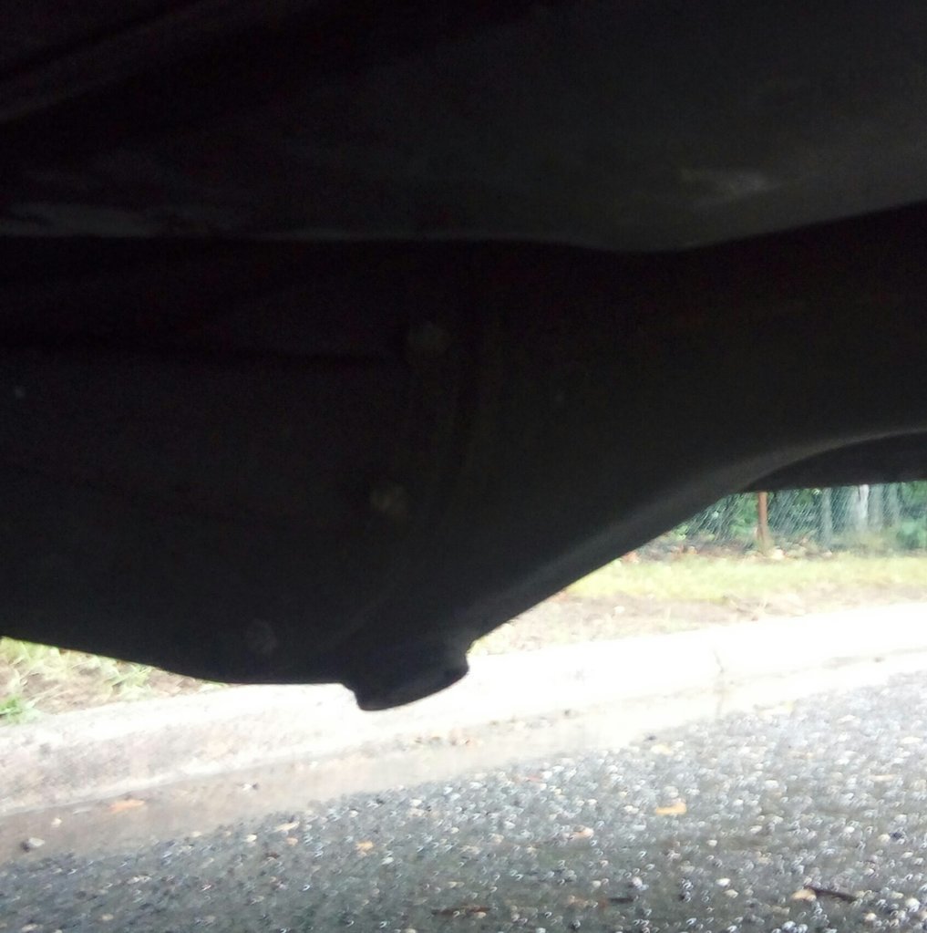

    5. Since the work was performed have to noticed anymore seepage or leaks? None- not great photo from today (raining out, so I took it before driving home)
    6. How many miles have you put on the truck since work was finished. Approx 3k
    Diff was dry, tech tightened bolts, on my way, still no leaks

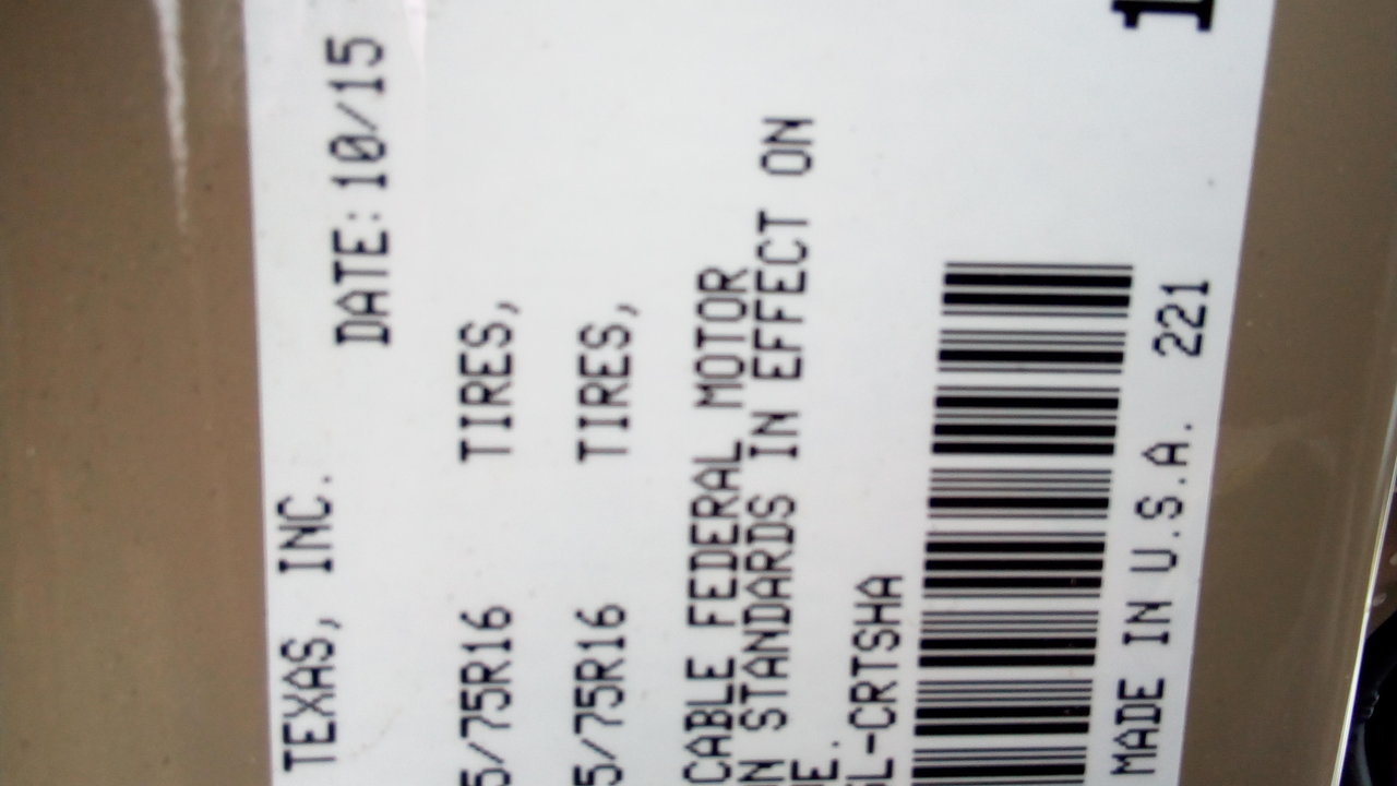

    Where do you find out the build date?
  6. Aug 15, 2017 at 12:52 PM

    Its on the sticker on the drivers side when you open the door.

  8. Aug 15, 2017 at 1:52 PM
    17tacosport

    Thanks
