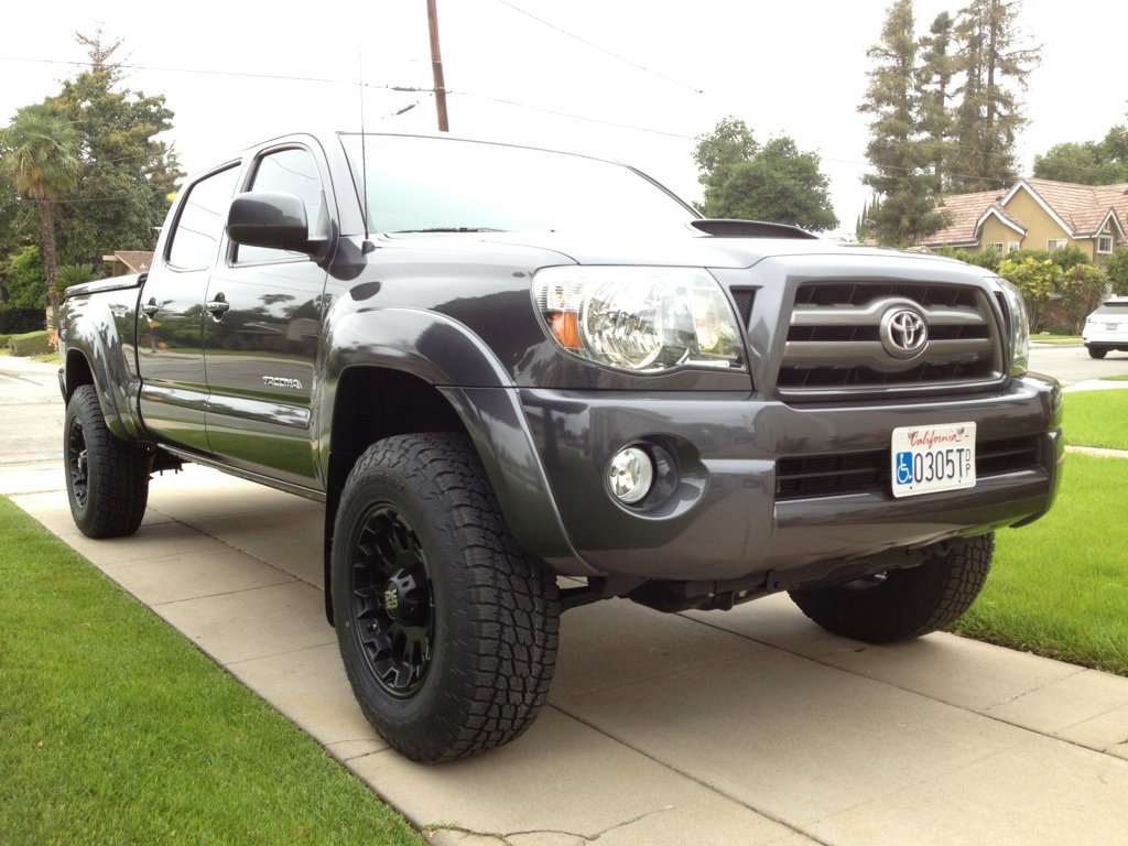

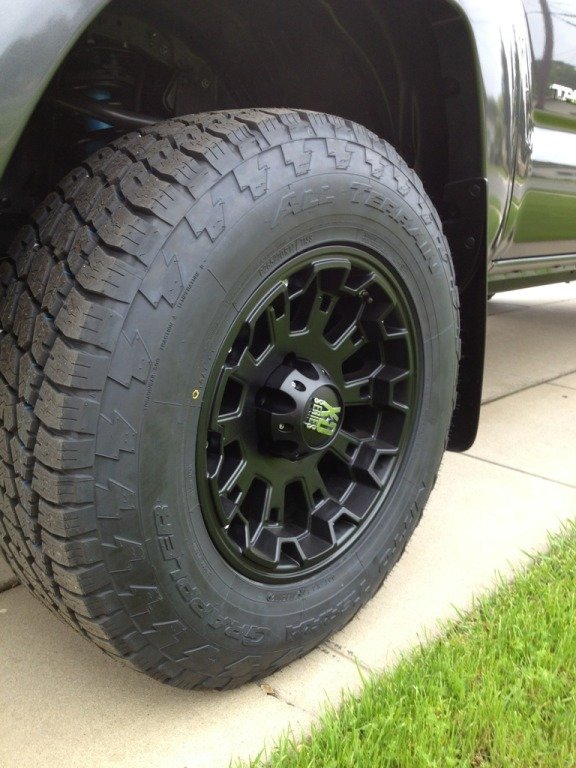

    I have 17x9, BS: 5.00" and P265/70R17 (113S) - Terra Grappler.
    This is how it looks. Hope it helps.
