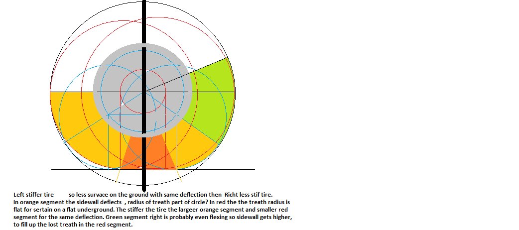

    A stiffer tire ( fi E-load AT 80 psi), needs higher pressure for the same load then a less stif tire( fi P-tire standard load AT 35 psi).
    That is why the chalc test ended up in higher pressure. The car advice of 32psi was for the OEM P- tire.
    Pressure advice is to give the tire a warm pressure- so deflection, so heatproduction a cycle , that wont give a temp of rubber of tire , above the critical temp, where it hardens and crackes. This may only happen ZERO times in a tires live.
    But warm pressure is inacurate to determine, because , how fast did you drive, and how long after stopping did you measure, and external factors influence the temp of air in tire too, like sunshine, severe braking, high Ambiënt temp.
    Cold pressure is simpler, when temp in tire i= temp outside tire. But then even advice is for 70degrF. , so if its 90 degr F , pressure is higher. But then it needs lesser deflection the higher pressure it gives, because cooling down of rubber of tire is also worse, because of smaller temp-differences.
    Then the chalc test.
    A radial tire stays over a large range of deflection/Pressure side to side on the ground, so chalc wears even.
    So it can be that chalc wears even, but still at high speed, the rubber goes over a critical temp.
    If doing chalc test, begin at to high pressure, and work down until chalc dont wear in the middle , then stop.
    Then you have the upper border.
    If you begin low, you might end up with to low pressure for speed.

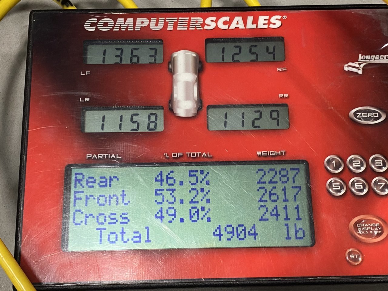

    Well thank god I didnt blow myself up driving across country without finding the tire pressure formula I was looking for. 1600 miles at 44 psi. Ended up weighing in close to 6900lbs. Rode great at 44. Will air down now that I am past the majority of interstate travel.
    Chalk test showed a hair of chalk left on the outer edges at this psi.
    Steves104x4, Key-Rei and davidstacoma like this.

    Damn, pushing 7000, you beefed up your frame at all?
    What all you got in that to make it so heavy?
    I'm similarly equiped to the picture of yours externally and I'm barely at 6k fully loaded down.
    Can only imagine that thing is a dog on the highway. What kind of gallons per mile do you get?
