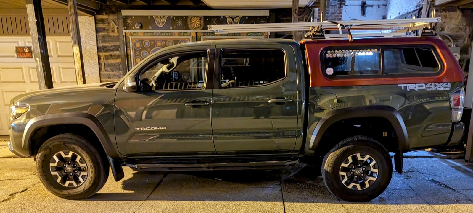

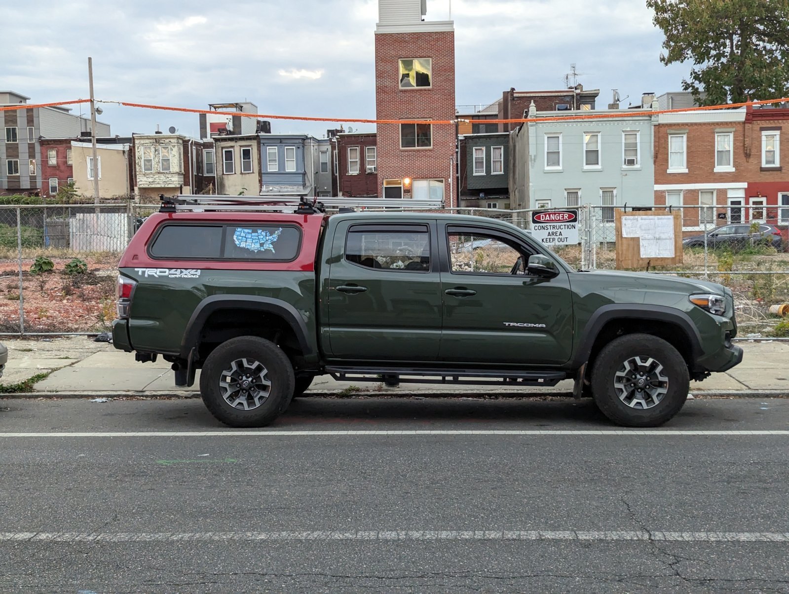

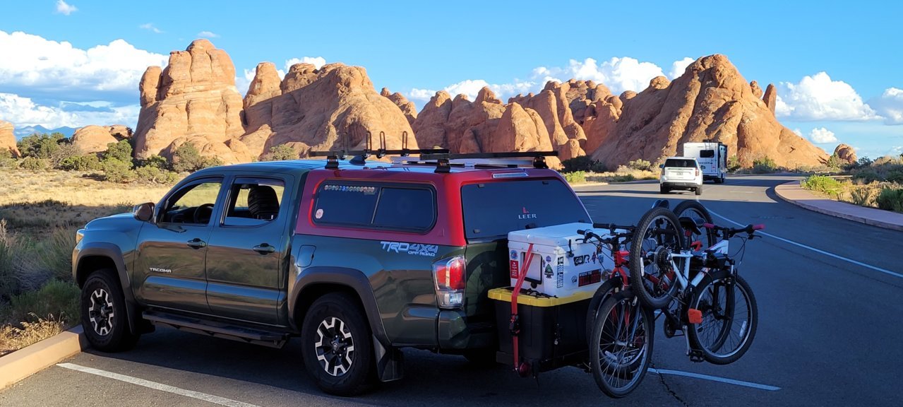

    Hey! I'm tired of squatting when camping. When I posted this pic previously some folks recommended an OME leaf pack.
    It's a '21 OR DCSB by the way. Everyday driver and I am pretty happy with the way it handles, I'm just tired of the sag. It always has the cap, roof rack (about to add weight up there with t-slot rack), solar system (100AH battery), and Decked drawers filled with fun.
    When I camp, I add the luggage rack and bikes. I scrape the bike rack when leaving some parking lots.

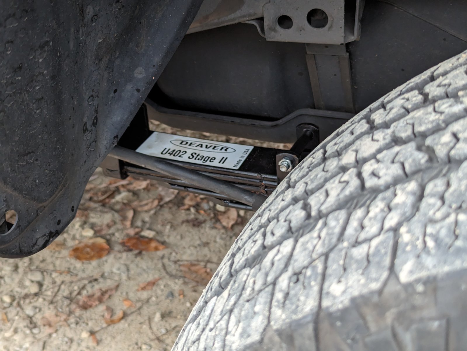

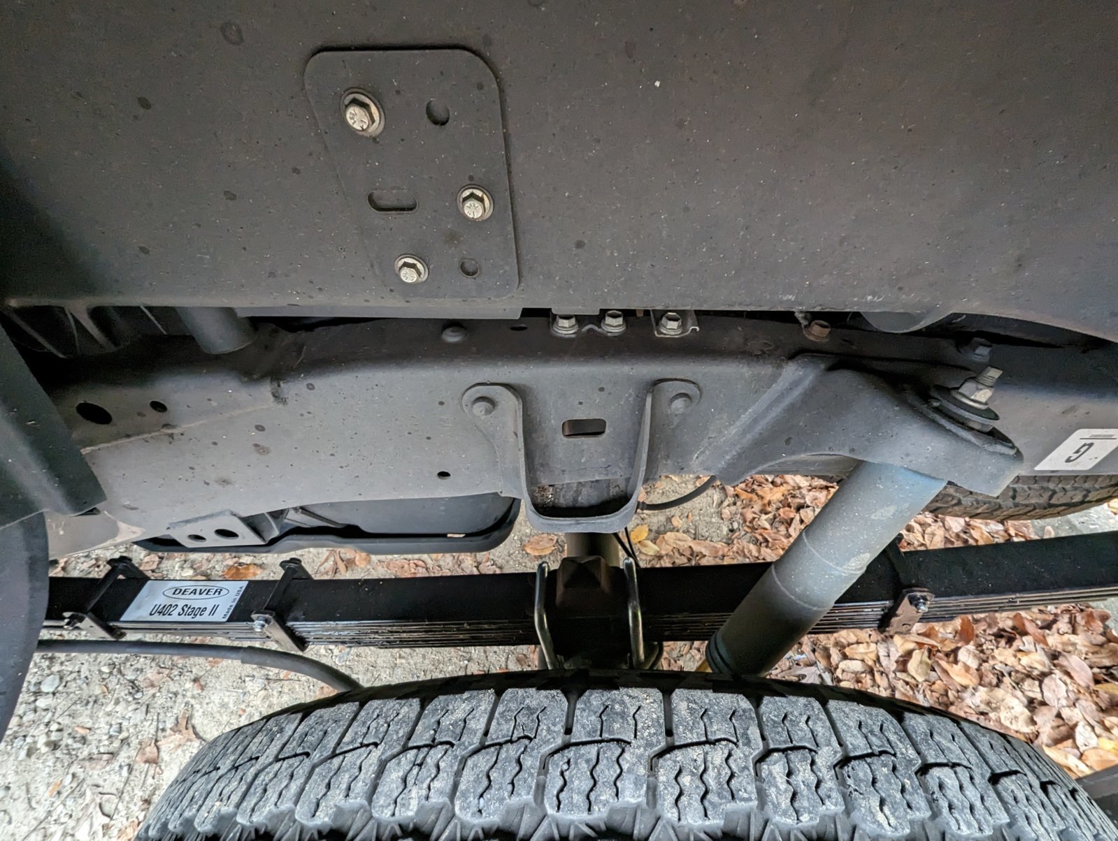

    I finally got my Deaver U402 Stage 2 leaf packs installed. No regrets. Mechanic said my struts are topped out now though because the lift was too much, perhaps they'll settle. I also have to reinstall my 100AH battery so that might help a bit.
    It rides so much nicer now and is much more stable at +55 MPH.
    Thanks for all your input!
