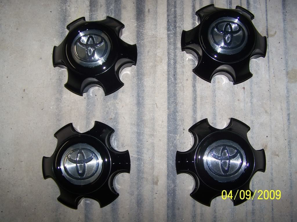

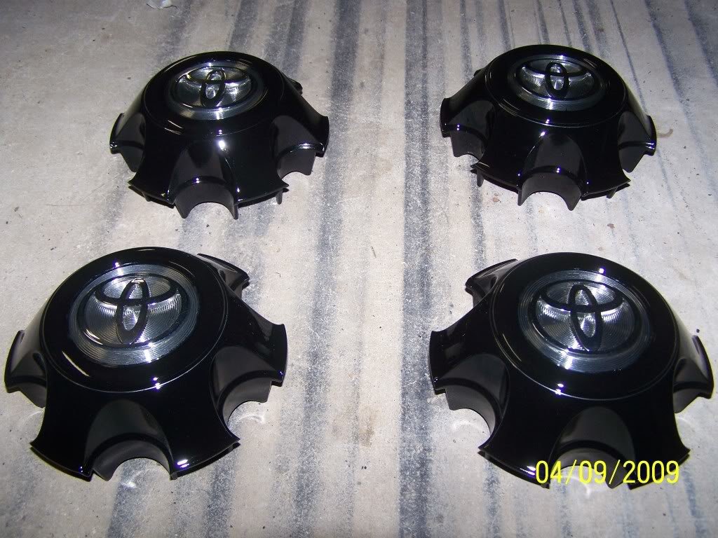

    I just finished the last clear coat on these. I will be doing the rims shortly.

    Thanks. I think their cool.

    What was your secret for letting the background stay the same color? the ridges behind the Toyota

    Those look pretty nice man.

    Looks like good quality work. I can't wait to see the rims.

    I taped it all off with masking tape while I did the blacking. The uncovered it to do all the clear coats. Use your thumb nail to tuck the tape into the crevice and the tip of a knife to trim the excess off. Make sure you leave a pinch in the middle to pick the whole piece off when you are done.
