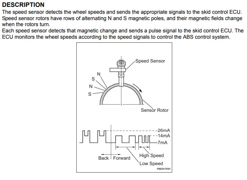

    I guess you could jack up the truck(make sure vehicle can't roll, put it in Neutral, disconnect the sensor and check for the pulses.
    https://www.2carpros.com/articles/abs-wheel-speed-sensor-test
    https://youtu.be/jG18XmUJoNU

    Sandman all I had was a voltmeter and I could not get it to read any voltage. I jacked up the rear and had my wife to put it in drive disconnected the connector over the rearend which has both the right and left rear going to it. Like the article states you should read AC voltage but I couldn't and I know my passenger rear speed sensor was good. Head scratcher for sure and I had put over 5 hours into tracing wires. Your diagram would have helped for sure on the wire and connectors. The AC voltage NOT showing up has me puzzled.

    The diagram shows amperage(mA), but to have amperage you would need to have voltage, so yea I'm not sure.
