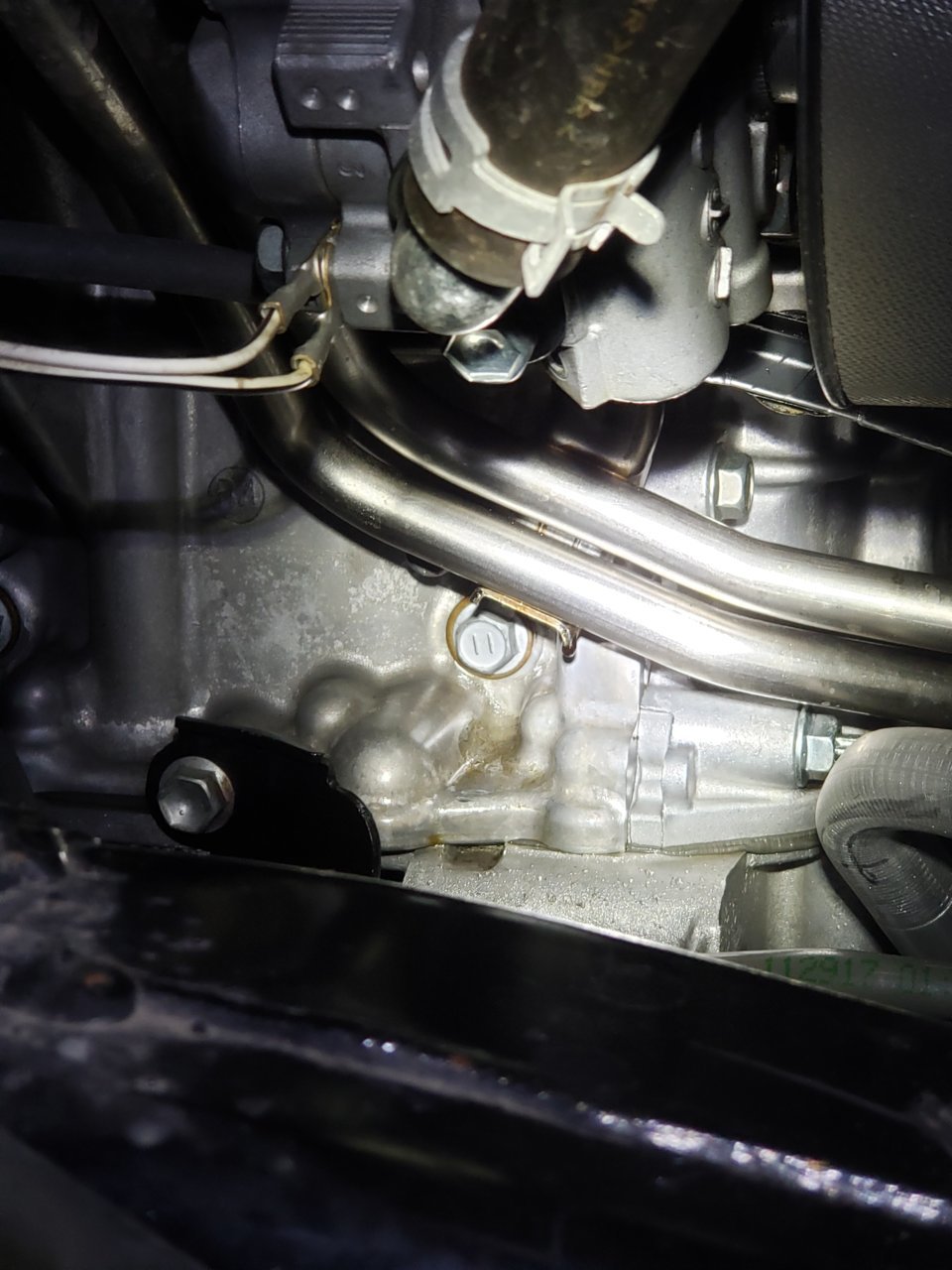

    Here's a picture of where I could see the fresh oil after I cleaned off all the old stuff. Its really hard to see where its clean oil but this is looking in the passenger's side wheel well behind the front splash guard. The oil was pooling up under that bolt but I could feel up above it and knew the oil was coming from somewhere above that.
    2000man[QUOTED] and mattleg like this.

    There's been a couple cases of timing cover leaks on the 3.5, the rear main seal as well. It's good practice to thoroughly inspect for leaks during oil changes. Also good to read all the service bulletins and do a thorough look over of everything before the warranty expires. It really sucks when you find a leak after the warranty, and yet in all likelihood existed while under warranty.

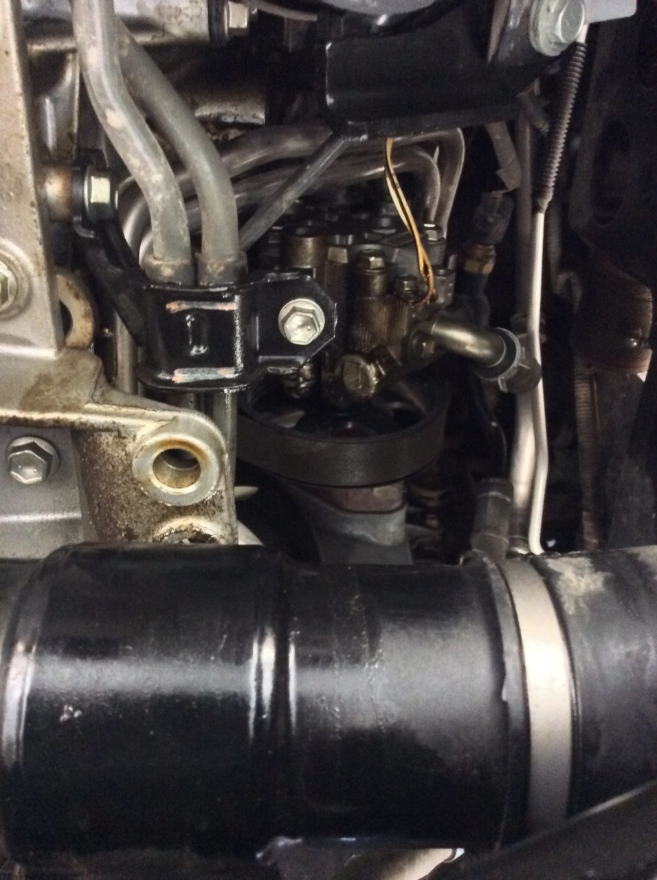

    Crappy pic but this is what mine looks like from the ground looking up.
    bowhunter13[OP] and mattleg like this.

    that looks pretty much the same as mine did before I went and sprayed everything off
