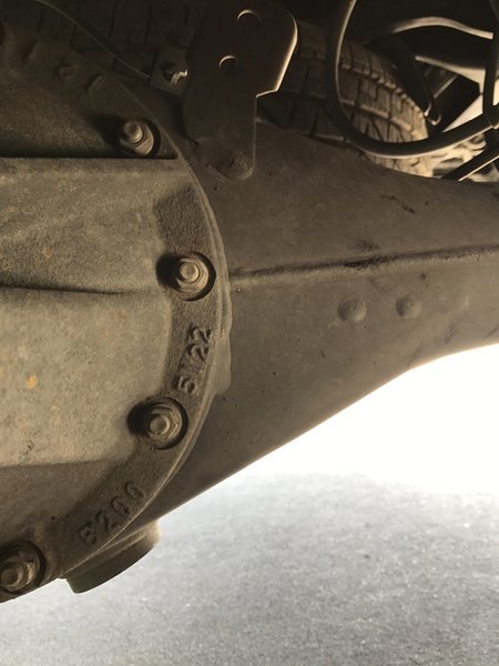

    I just checked mine, they were unevenly torqued, bottom were tight, top were lose no leakage whatsoever, and yes I agree
    with Nitori, these are 12mm bolts 33 ft. lbs. could be a bit much.
    You'll need a 3/8" torque wrench, a 12mm deep socket to avoid using an extension which can throw off your torque value.
    I tightened mine by hand instead, as I pretty much know by now the fastener stretch limit in a crisps-cross pattern like you would a tire, or up to opposite bottom, left side to opposite right side. I'll just be avoiding a trip to the stealer and steal his warranty $$ lolo!
    Hope that helps!

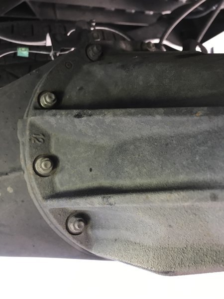

  13. Apr 27, 2017 at 1:34 PM
    EatSleepTacos
    Mar 24, 2015
    #151688
    59,833
    Randy
    West Valley, AZ
    2017 4Runner
    That really sucks! So maybe people should just stop messing with their diffs and let Toyota handle it, because now they'll blame this on you.

    Called my dealership. They told me they were aware of the recall and he spoke to his service manager who reviewed the recall and they "probably" would replace all the bolts even though there was no leak. Maybe this is a bad bolt issue? Appointment next Thursday morning. We will see. I mean holy poop my fingers can tighten to 18. (Exaggerated).

    16.5 ft. lbs. of torque is common on Japanese motorcycles for an M8 bolt, so 18 ft. lbs. should not have broken off a grade 8.8 stud.

    If you use a long flex extension or a universal adopter in conjunction with a long extension to gain easier access to the top bolts, your torque value may get skewed. Safest bet is a deep socket or short socket with straight short extension. Or at least that has always worked for me.
    Thank you MetrickMeta, yes there are charts for studs and fastener torque values, I was referring to the nut diameter size that takes a 12mm socket and I miss wrote it. My bad, but to my defense, I don't have all day like $hitty99 I do have to hurry sometimes. Mia-culpable.
    I don't think that was your fault man, it was prob factory's, I did mine no problems some were loose and I'm glad It's over for me.
    Nah, I have no problems with my diff or any issues with my truck and I solve/fix my own issues, no crying here.
    And this is a real minor stuff, nothing like your hollering about a diff. So you get no apologies and you're still a dick.
    "probably" sounds iffy, and I truly believe its their fault. If they had the right torque from the get-go, you wouldn't be under the truck for that in the first place.
    E'fm I would take some rear diff oil and use a squirt can and just barely put some on the other side along the gasket and say you saw it and panicked and proceeded to check and set your wrench to 18ft lbs and this happened.
