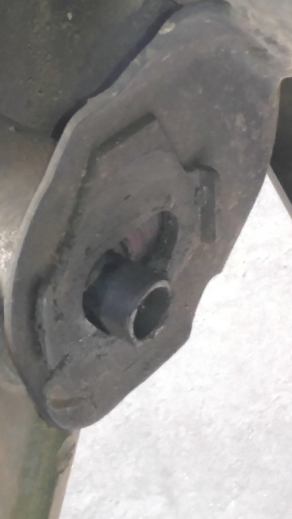

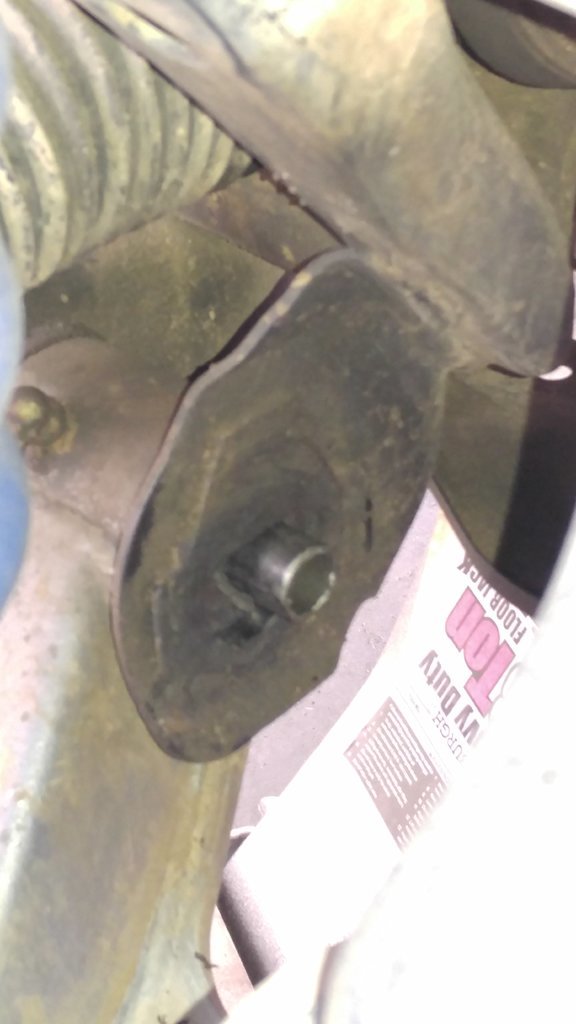

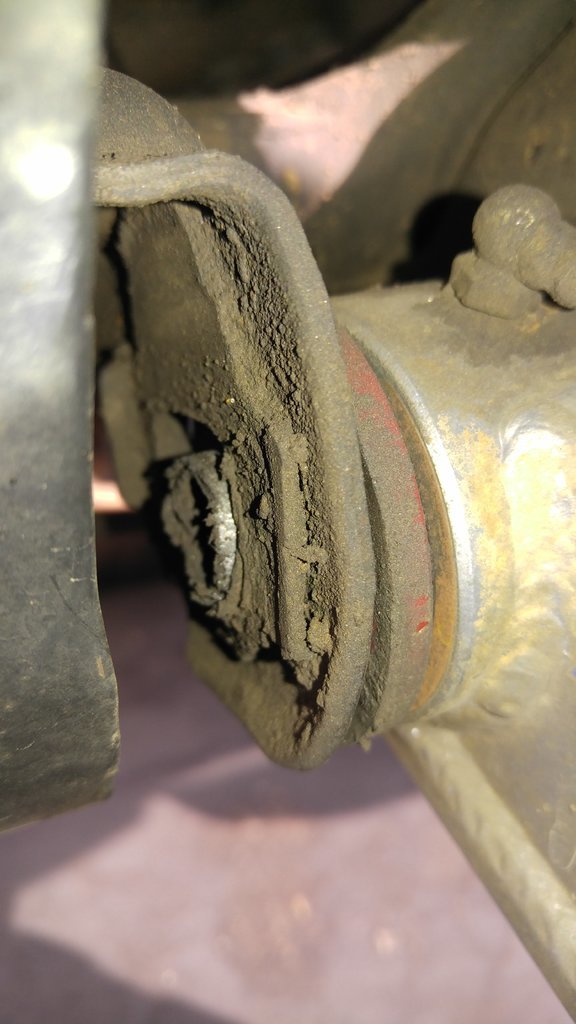

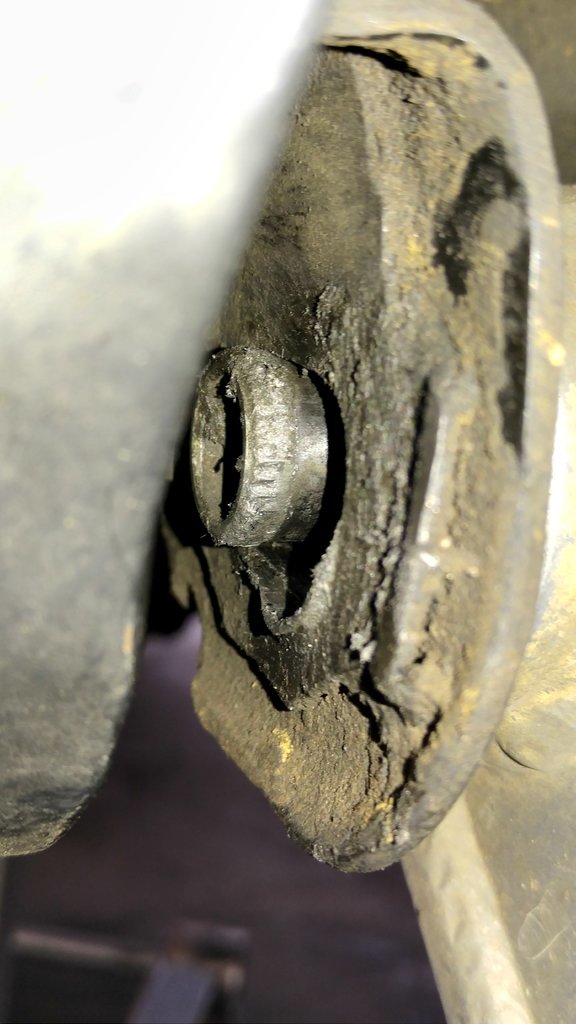

    Camber bolts are gone! Took the truck off road about 2 weeks ago everything seemed fine.this must of snapped off in the fwy because i thought i heard a strange noise. i cant believe i didnt cause an accident i feel really blessed right now. This happen to anyone? Any advice on temporary fix ? Picking up some replacements at the dealer soon

    put a bolt and nut on it that fits properly until you get the correct bolt/nut/camber adjuster from the dealer. I would get an alignment done once you get the parts from the dealer since it almost certainly has moved.

    When's the last time you got an alignment? Techs not torquing the bolts properly seems to be pretty common

    Yes. The toe plate is pressed on to the knurled tube. I deformed one and it partially released. What happened in your case is toe plate came all the way off.
