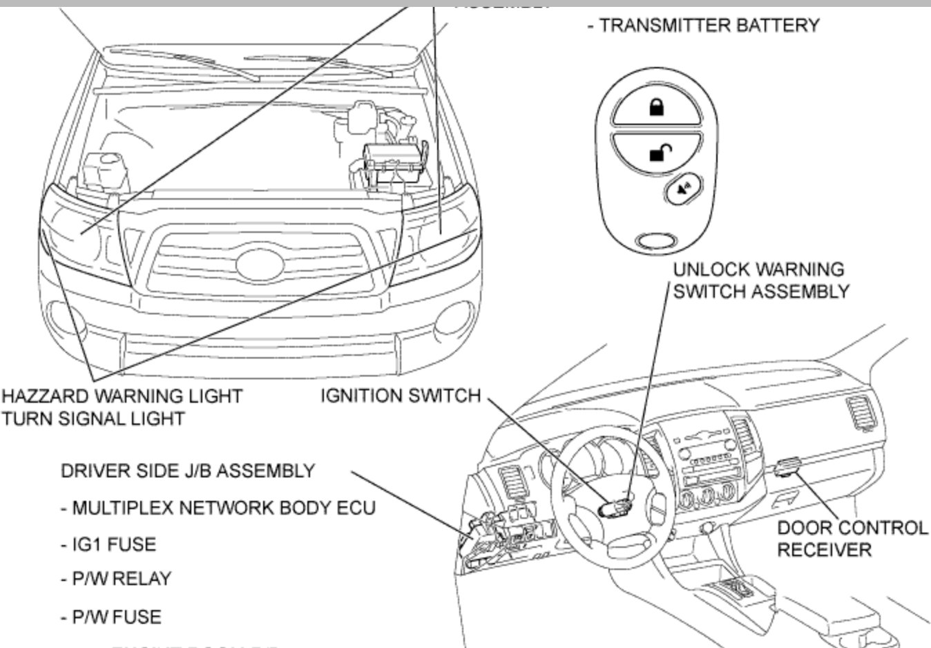

    bought the truck used came with one key set.
    Years later all of a sudden, fob remote lock/unlock button range decreased from distance, to you have to be standing next to a door basically.
    anyone know why?
    long prior to that, case was changed to AJT Designs fob without issue
    and have confirmed known good battery
    Also looked inside to verify battery contacts not overly flat or anything
    from what I’ve read, the signal reciever is a box hidden behind the glovebox. Searching the part online, they look robust.
    I’m guessing the fob has simply gone bad from high age and may have something to do with the circuit board inside, and need replacement.
    after all, the overhead temp display also has a circuit board and we all know that goes bad over time. But that’s fixable by re-melting the solder connections that visibly crack.
    might try throwing two new key fobs (and one blade) at it to see what happens. I think there’s even a 2-in-1 version out there to integrate key and fob.
    I’ll have to find that recent thread showing cheap tools and parts list needed to DIY this.
    I’m just not 100% sure yet if the reciever is in fact what I think it is, and can be ruled out.

    The door control receiver is in the dash, just as you stated.
    The aftermarket key fob would be my first suspect.
    you might try manipulating the buttons with out the case if that’s even possible?
    I can’t see the receiver going bad in a way where it would pick up signal.
    Maybe if there were some kind of sound deadening or heat shield that someone installed in the truck that might block the signal. But that too is highly unlikely to interfere with the signal.IMG_0393.jpg
