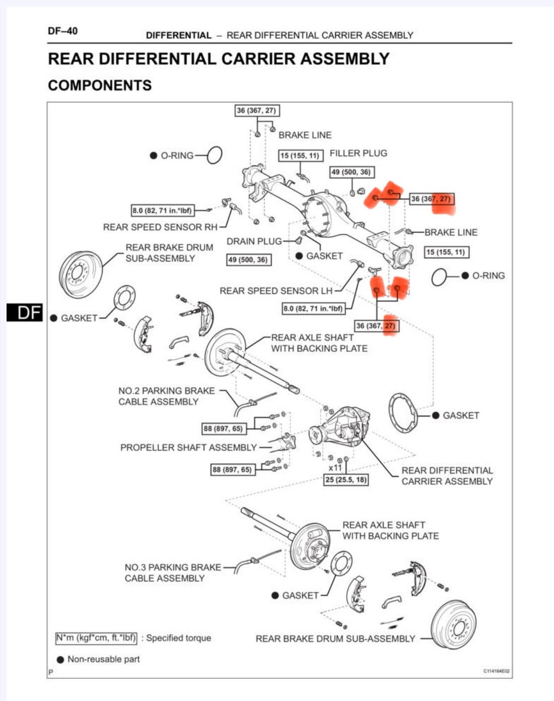

    Recent recall, rear axle, both sides.
    Check the highlighted nuts. 27 lbs ft

    What I don't understand is how "welding debris" could affect those nuts. Does the backing plate have the welding debris on it that wouldn't let the nuts seat correctly, or... ? I'll be checking the torque on those nuts tonight while the weather is over 40 degrees and we have a little sunshine.

    so the idea behind us on the tundra, was welding debris didn’t allow the axle retaining flange to sit completely flat. This allowed the plate to vibrate or flex, and nuts to loosen

    As part of the recall, Toyota will have an estimate for how many axles they'll need to fix or potentially replace. They need to have that number of parts in inventory before they can start the formal process. They'll need some time to produce enough replacement parts and get them into US warehouses before starting the recall.

    Understood. So if that is the case, then re-torquing them down may not resolve the issue, just delay it. Sounds like the axle retaining plate is what Toyota will be stocking and replacing if there is welding debris in the way of the two parts being able to sit flush.
