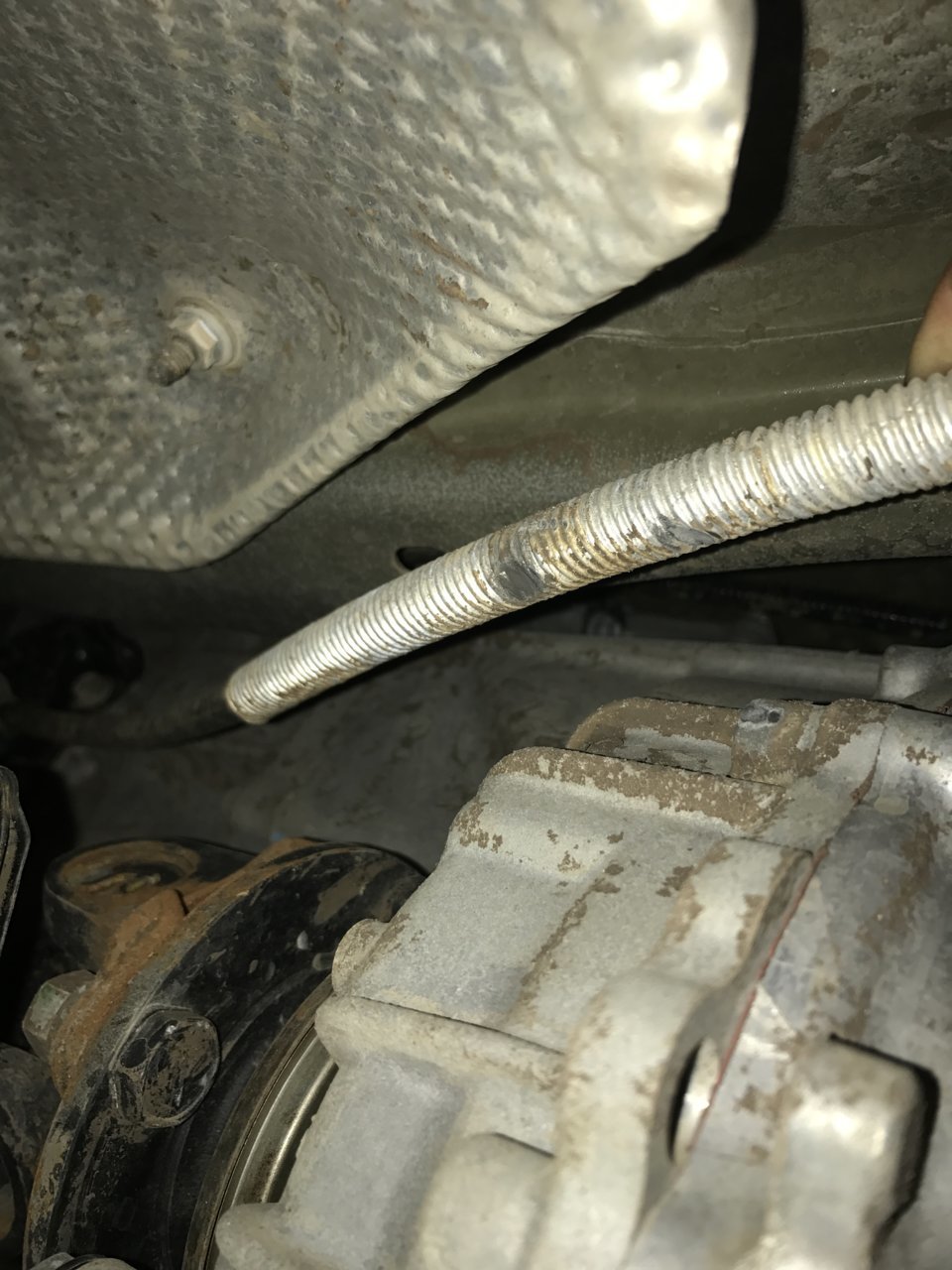

    While servicing my truck today and greasing the front drive shift I noticed that my parking brake cable has enough slack to hit the yoke at the transfer case. Inspected and found some rub marks on it.

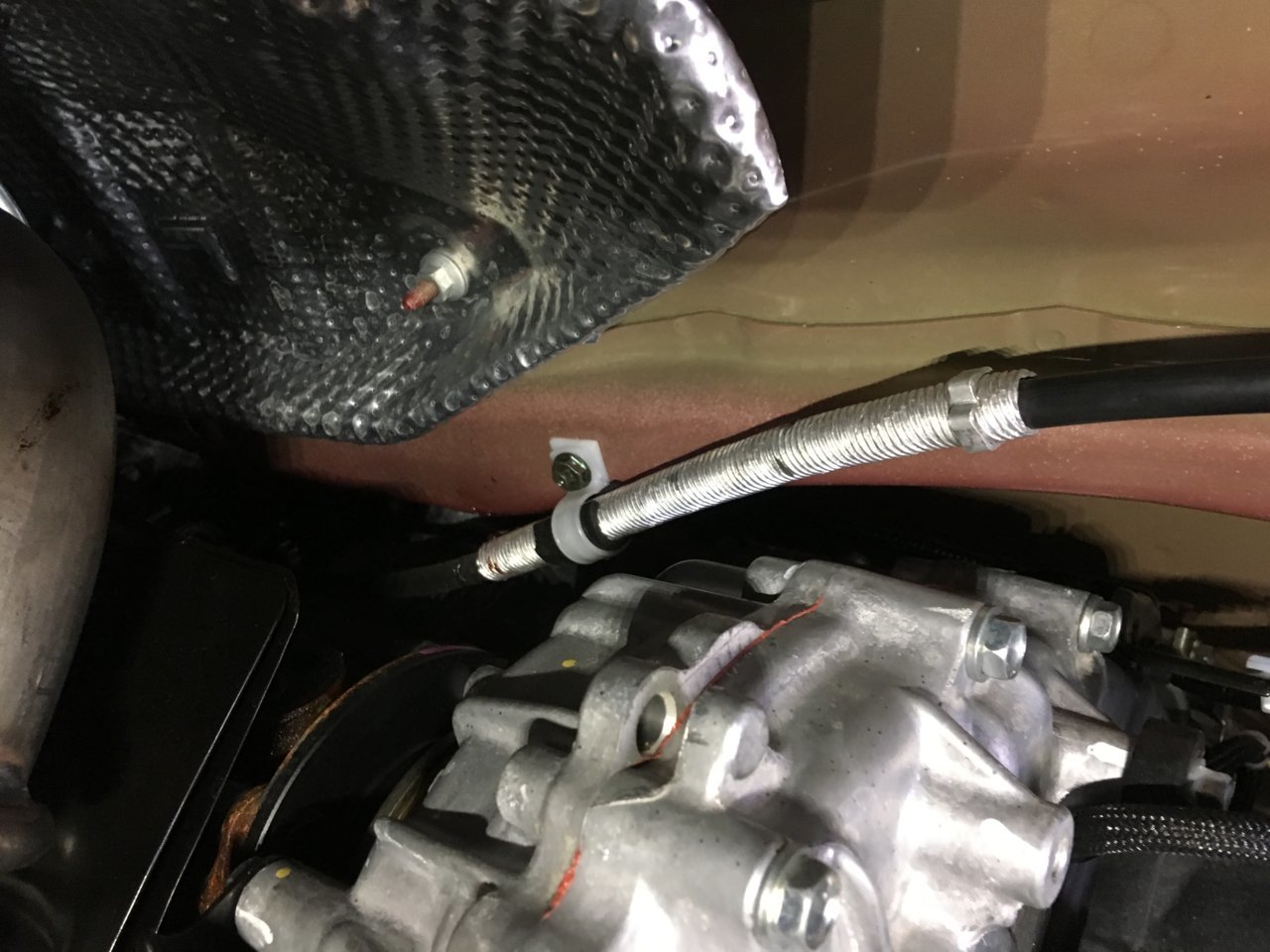

    I secured mine up by using a license plate plastic clip in nut and a bolt on clamp.
    Anyone else noticed this or had an issue?

    This?
    Almost forgot I'd done it.

    Yes exactly, going to go out on a limb and say they’re all like this then

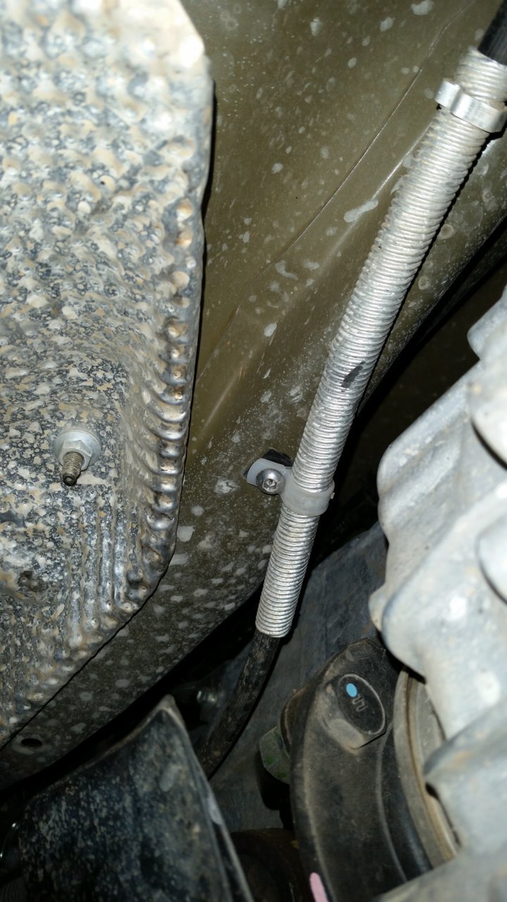

    0E3219B9-96D4-4A03-8AD2-BD987A250E88.jpg Just secured mine with the plastic insert and screw method , awesome mod , thanks for the tip!

    1... keeps it from slapping against the side of the T-case while you are driving , 2...possibly helps with some of the buzzing at certain rpms 3... fun easy project in the garage on a Sunday afternoon. 4.... may reduce stress

    Had the same thought , it actually just moves it about an inch away from the case , still seems to have plenty of movement

    No drilling , using existing stamped hole in cab unibody support , check out the thread listed earlier , great pics, or see below lol
