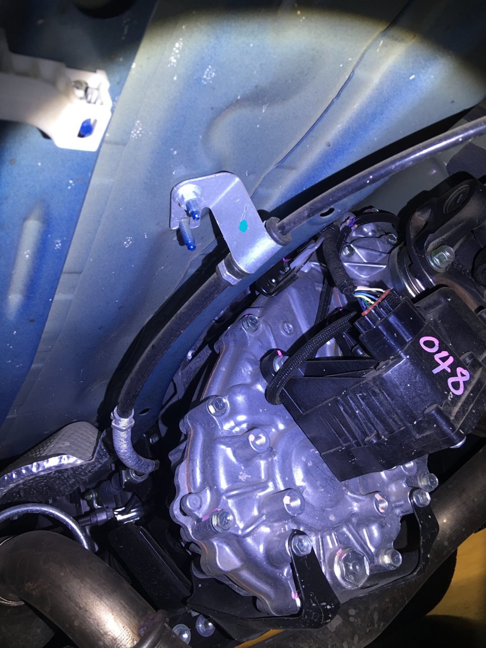

    Looks like they rerouted that cable on the 2019. I couldn't find a cable in that spot on mine.

    It’s not actually a brake cable , it’s the auto trans shift cable , you have a manual trans so you are good to go

    I'm a total noob. Can you guide me step by step where to find that cable?

    Left (drivers) side approx under drivers seat area, right next to transfer case

    It’s an internal cable and you aren’t shortening the length just repositioning so won’t hurt anything (so long as you’re not bending/linking it)

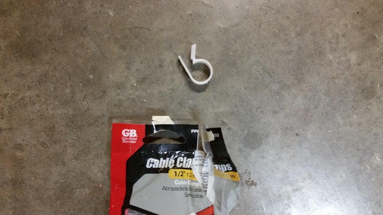

    Stupid question... anyone know what size that plastic cable clamp thingy is? Looking on Amazon/home depot whatever, there's a lot of different sizes. Don't think I have any on hand, so I'd have to buy one, and wouldn't want something too small.

    I just used a standard plastic license plate insert

    I just looked at mine and it has a bracket holding the cable further back. I don't see any rubbing on the housing. Does everyone have this bracket or was it added to later manufacture dates?

    I used 1/2".20190818_200731.jpg

    Yes they all have that bracket , but some of the cables lay much closer to the transfer case housing than yours does . My aluminum sheath actually lays against the t-case until I did the clip mod

    Interesting, mine appears to have plenty of clearance, but I will keep and eye on it.

    I checked mine too. I have the bracket and it’s not even close to touching anything, especially the transfer case or yoke.

    Mine too. Its an 18 built in 2/18. If that helps anyone.

    Thinking about it...
    I wonder if it's a matter of how the cable is 'timed' on the support bracket forward of the rub area.

    i wonder if it could be readjusted to change the play in the cable
