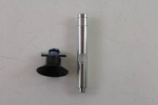

    Use one of these to check the pressure and air up that spare that's mounted with the stem up (should you have a nice wheel and want to keep the pretty side up to help keep it looking pretty): [​IMG]
