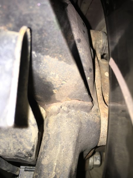

    Fuuuuuuu just realized thanks to @anthony250f that my spindle is cracked. I have identical crack to the OP with non sway bar version
