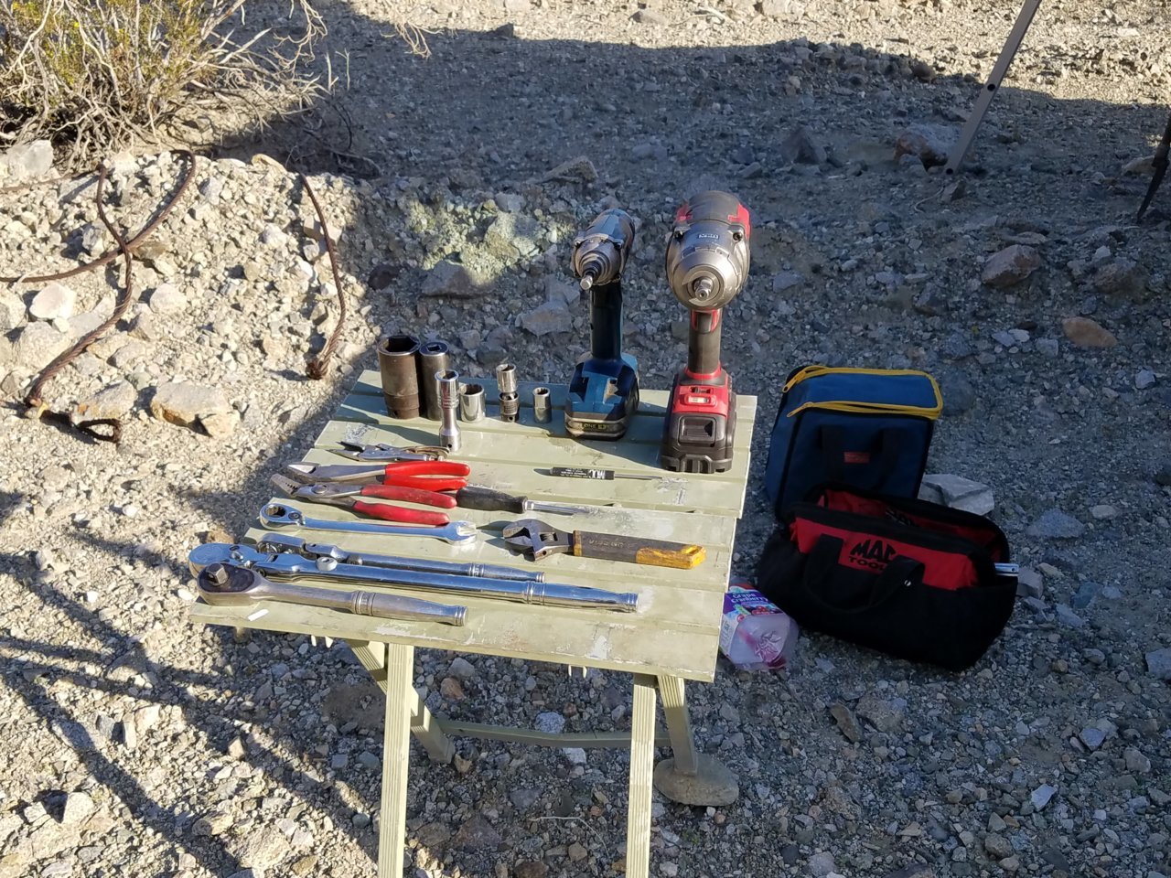

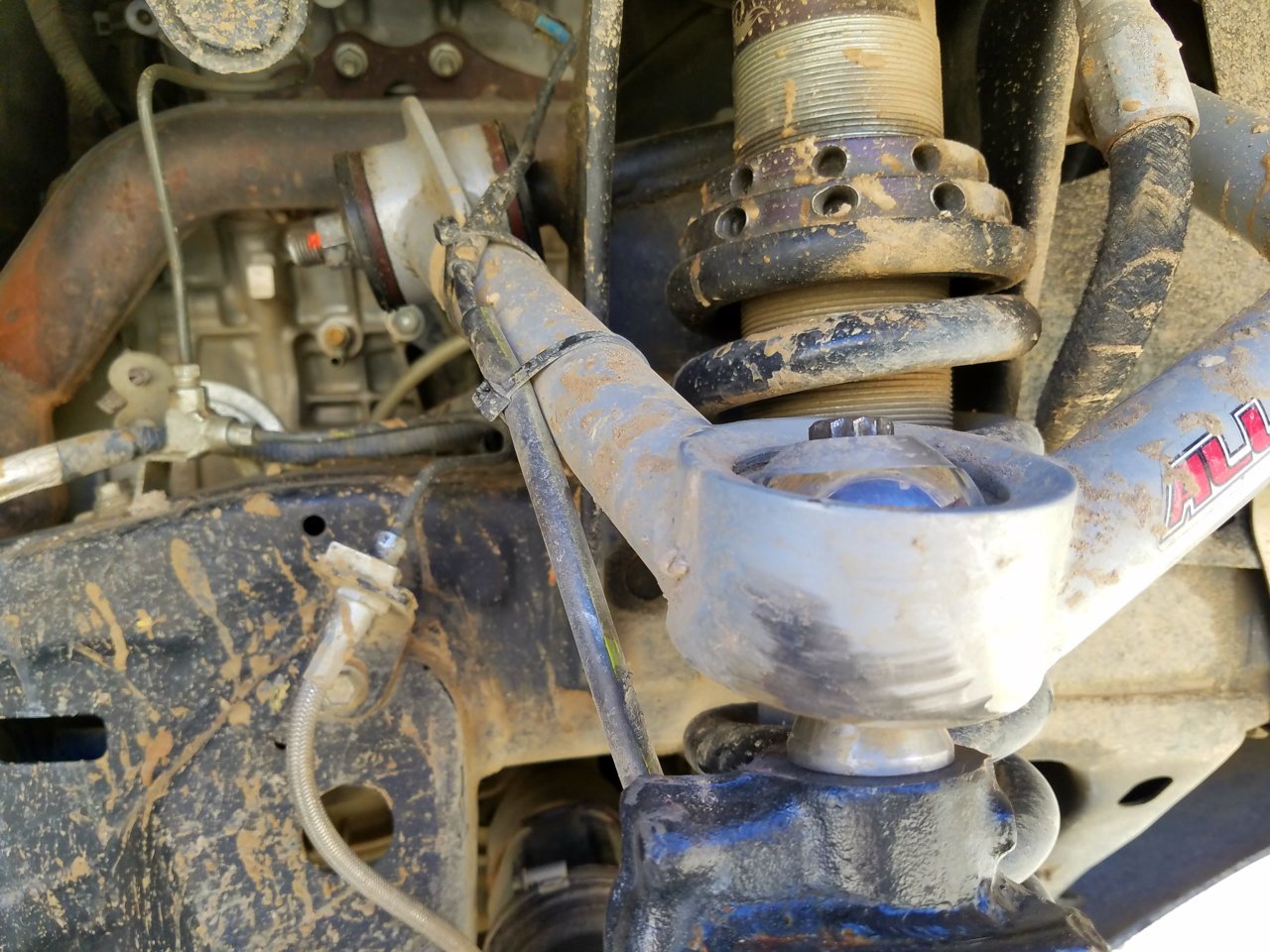

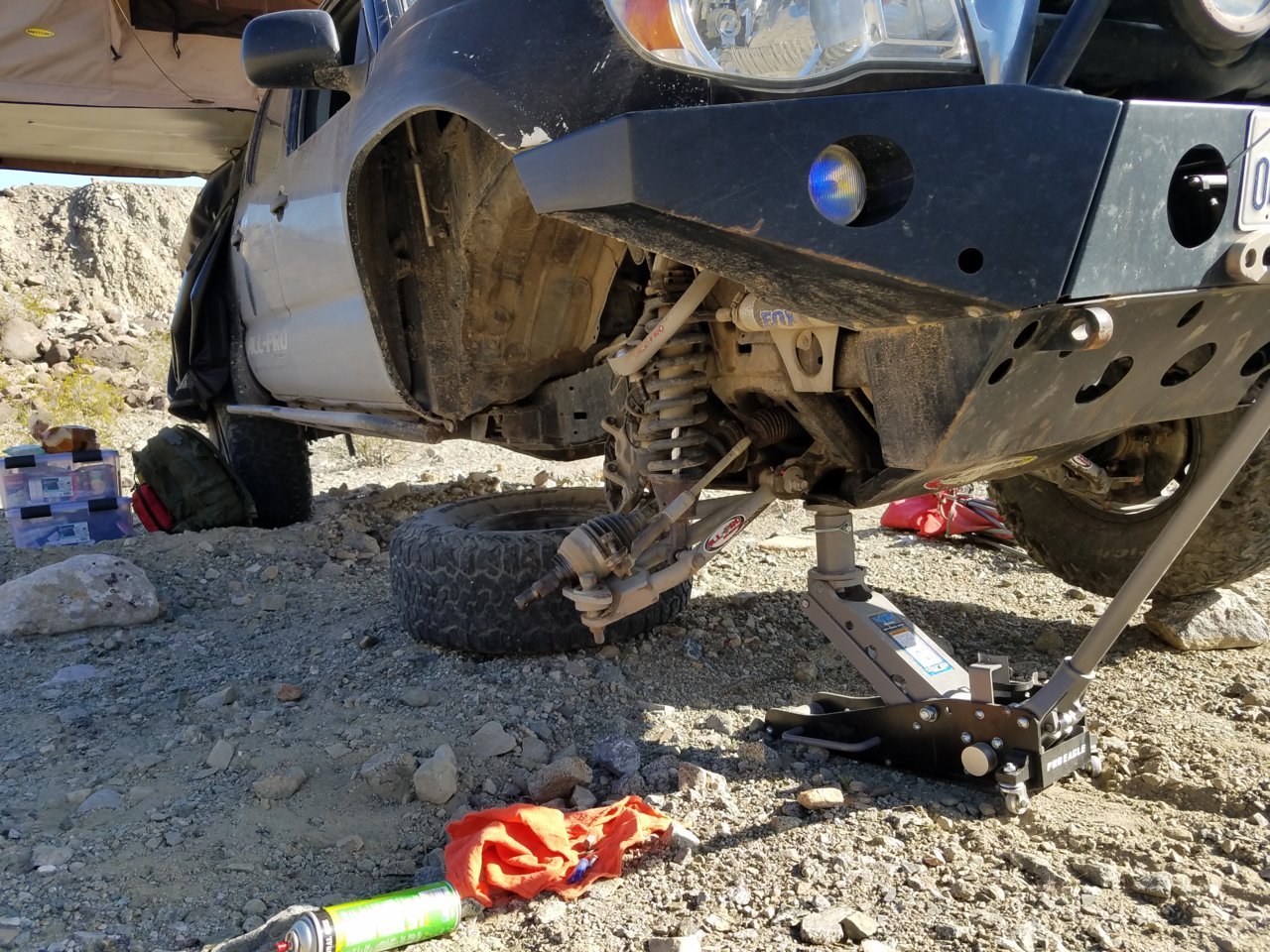

    Bent the passenger side spindle and cracked the gussets yesterday. Tagged
    a large rock that couldn't be avoided.
    Bent enough that the tire was rubbing when turning passenger side.
    Had spares on hand and swapped it out while on the trail. Didn't take long.
    Organization is everything...

    What jack is that?
