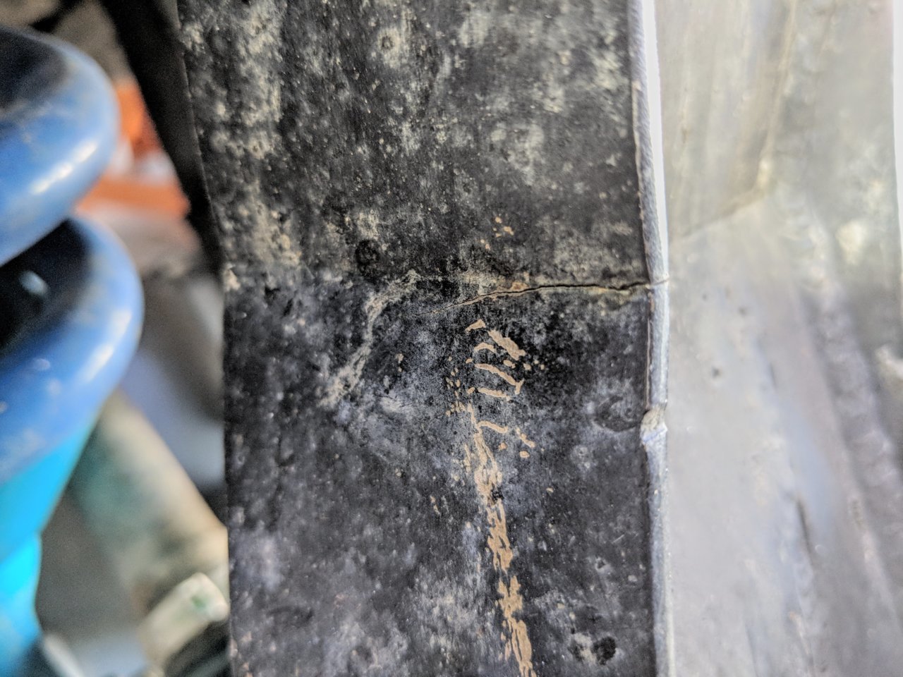

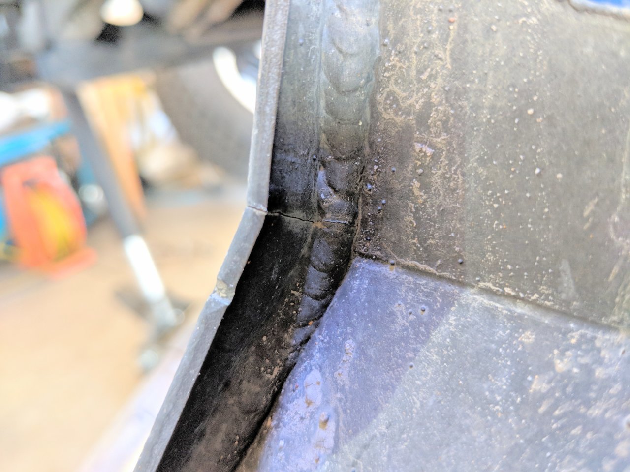

    Cracked "Truck Shop Gussets"
    The crack is on the driver side, it's not in a critical area. I'll have to grind out the cracked part of the weld and put a bead back down.

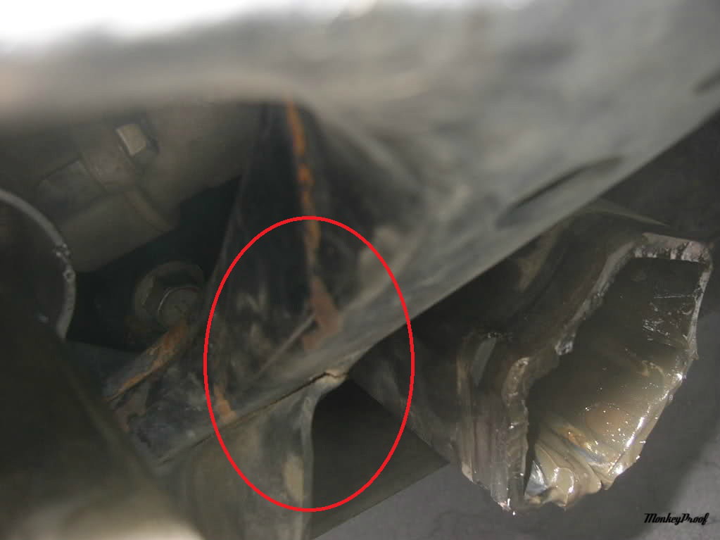

    So now I guess its time to start a thread to check your Lower Control Arm Mounts?
    Front Driver side
    Front driver side rear
    Front passanger side rear

    looks like the gusset needs a gusset

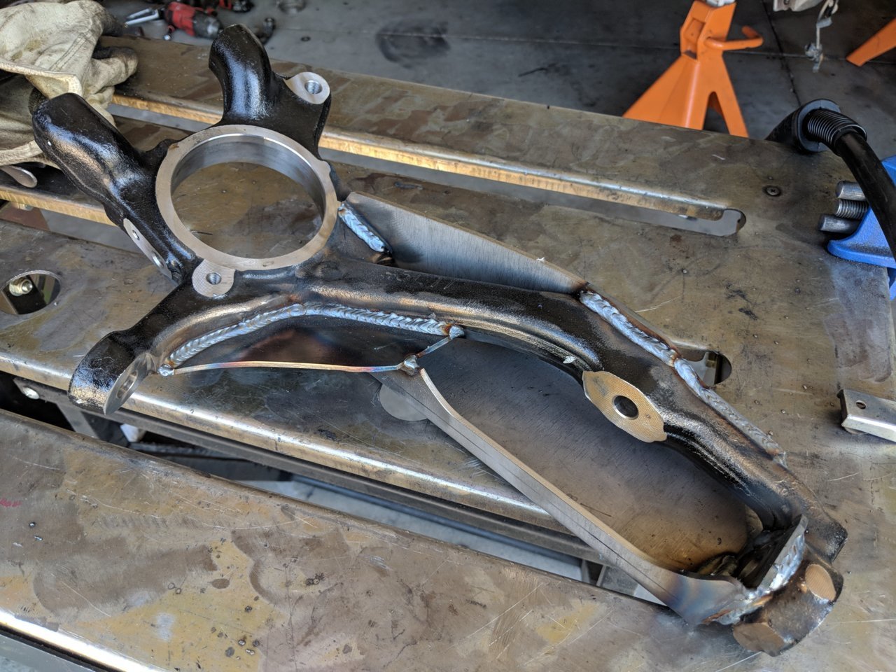

    So what's the consensus here? Do the spindle gussets really help with keeping the spindles straight? And if so, the TC sway bar version is the way to go? I don't think I recall seeing any failures in this thread with the sway bar version, but only the non-sway bar version.

    Yes they do help keep the spindle straight.
    Yes, only use the sway bar compatible version.

    Good deal. I've got me a spare set of spindles, just need to buy the gussets and weld them on.

    far more people have been stranded with bent undrivable spindles than broken gusseted spindles. I won’t get into the rest of the questions since they’ve been beat to death on here
    also find me a pic of a broken spindle with total chaos’s newer style sway bar gussets.
