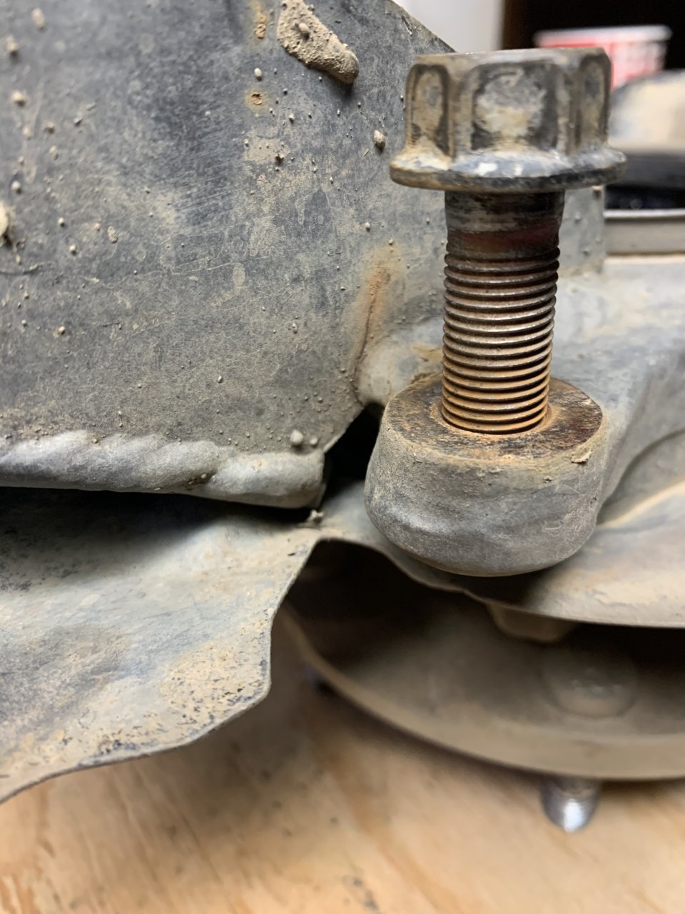

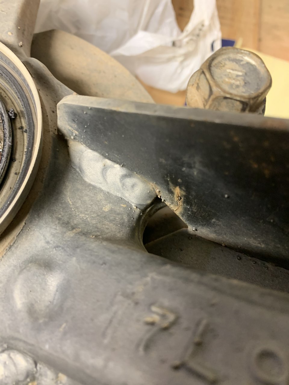

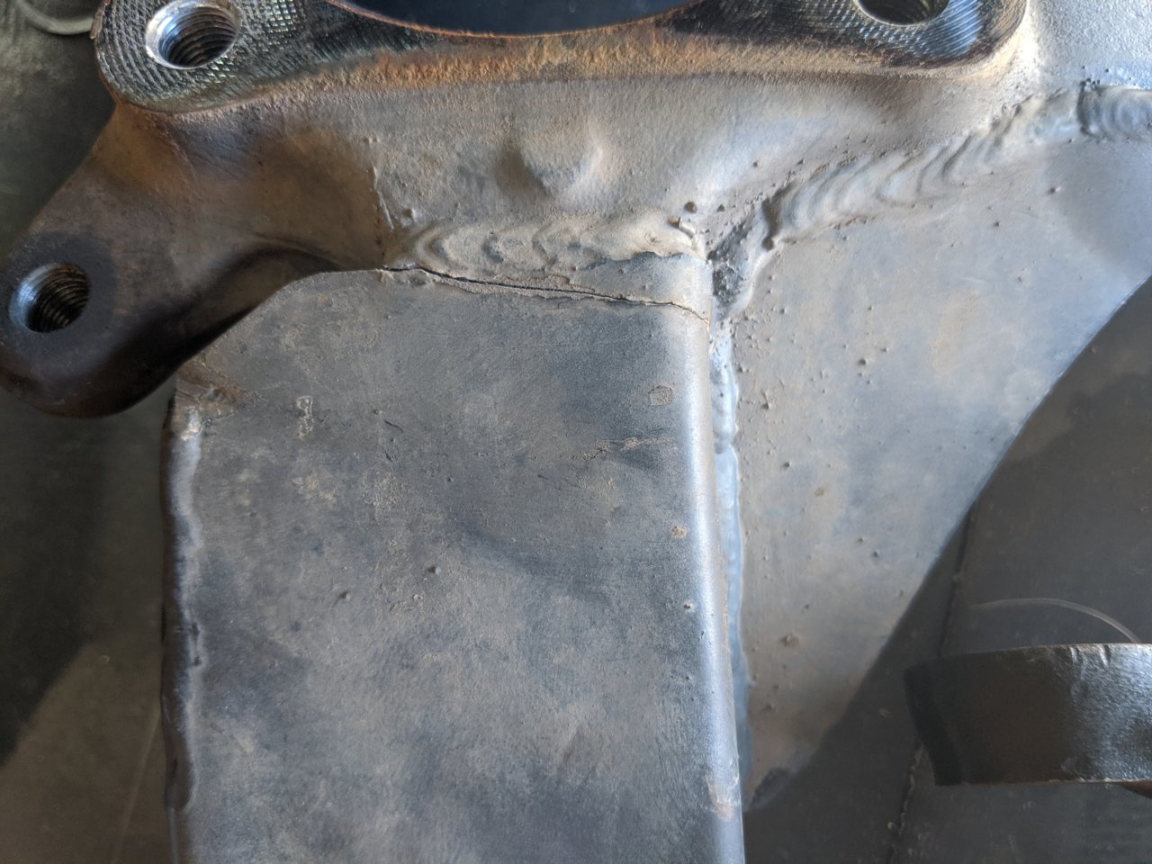

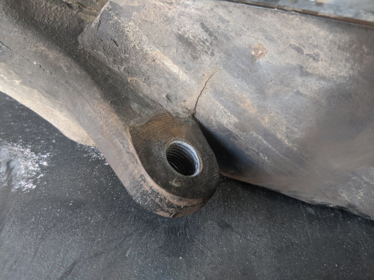

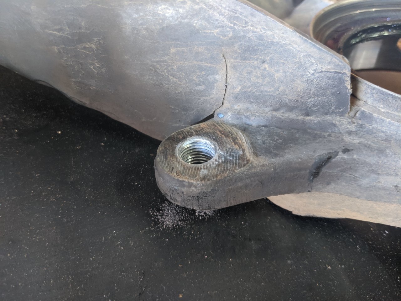

    Uhh, yeah.......
    IMG_20191029_101914.jpg IMG_20191029_101942.jpg IMG_20191029_101917.jpg IMG_20191029_101928.jpg
    whatstcp and jberry813 like this.

    Driving fast like a retard is the main cause.

    I don't think it had anything to do with the 37s. But I've had other things happen that they might have influenced ....
    Slashaar and FJMTBR like this.

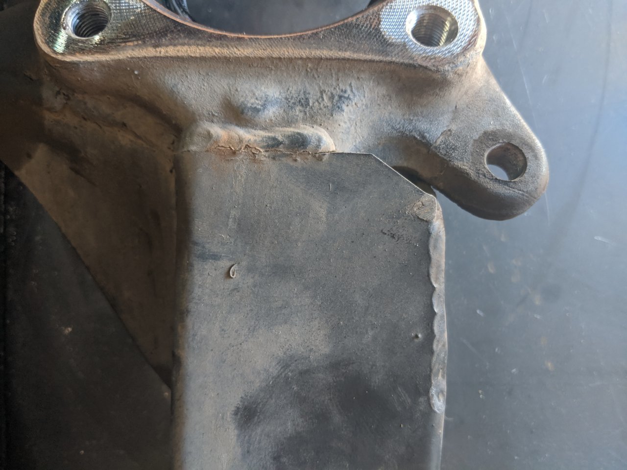

    I've got my fun money stretched out on 2 trucks now, I've got a vagabond on order for my other truck so no big purchases for a while until I've got all that paid off.
    I just repaired these, I just filled in the cracks and added some weld wrapped around the edges/corners where I should have put in when I welded them up originally. Gonna put them back in and see how long until something cracks again. I find it odd that 1 cracked along the edge of the bead on one, but the other started cracking through the base material. Maybe got better penetration on one than the other?
    Admittedly, I've been driving way faster than I should be...... I somehow dented the inner lip on one of my wheels and had to get it repaired since it wasn't holding air.
    I'm going to try and stop driving like a retard, every time I go to fix something I find at least 3 other things that need repaired or fixed. It's getting old. :frusty:

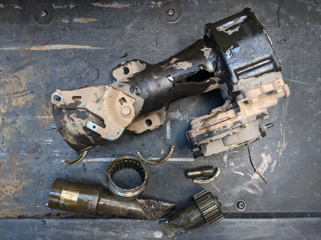

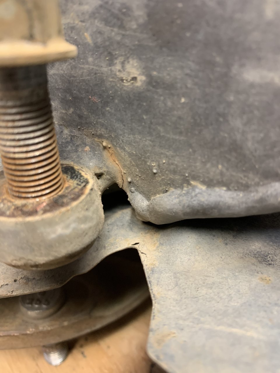

    B10984B5-FF14-43DB-AE08-8FC67B7BC6D1.jpg 174EEDC5-73E9-4C3D-BE2E-ADA2E497E696.jpg 9AD63242-4B4C-40DC-B3FF-29F997A8B36F.jpg
    deeezy and tetten[QUOTED] like this.

    I resemble this statement.

    Quit driving like an asshole. :cookiemonster:
    Knowing I'm not the only one having consistent issues makes me feel slightly better though. Looks like youve got some cracks in the same places I had them too.

    Pretty much, I drive my MT truck like an LT truck, its just so damn fun though and handles it so well.
    Yeah, I am fine with it and not really surprised, not great but better than bending the shit out of it and being stranded. Patch it up and move on. I probably should pick up another pair and have them on standby, these have been through the wringer. Or build a jig and work on a fully fab'd one, I don't think it would really be that tough of a project if I have the time to take it slow and work on it a few hours here and there.
