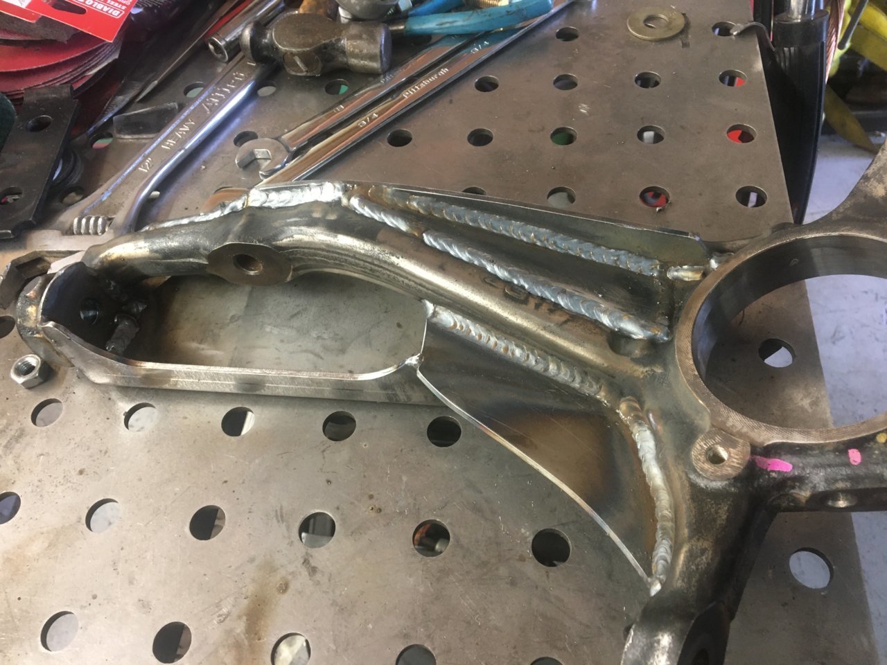

    I’ve sold a few pairs to guys. I’ve thought about running them, but I’ll probably just switch to an lt kit that has fabbed if I decide to go that route. I will say that they are very nice. But to me you still end up with single shear upper and lower uniball mounting. But if you’re staying mid travel or +2 you won’t find a more solid setup.

    White, debadged, Mudflaps removed, ICON 2.5 in front, 2.0 in rear, all 4 corners have reservoirs, Spidertrax wheel spacers all around, BAMF bolt on sliders, Avid lightbar, oem transmission cooler converted to power steering cooler, aftermarket transmission cooler eliminating all oem transmission cooler stuff, remote mounted spin on transmission fluid filter TrueTrac rear differential, rear diff housing vented and filtered into left side bed box, URD MAF calibrator, Volant intake scoop into oem airbox, second filter removed, airbox internals smoothed, blended and polished throttle body, NST intake manifold spacer, Wet Okolee set covers, WeatherTech Digital Fit mats, inexpensive JVC single DIN, Scangage, AVS Stepshield door sill protectors, Doug Thorley Long Tube Headers, URD Y pipe with O2 sims.
    Glorified welder. Not sure this is viable. Do you have a Toyota dealer you work with to purchase new spindles? Rather than dealing with shipping costs to you, can you pm me a quote on new oem spindles for a 2010 DCLB Prerunner, accomplish the gusset install and ship to 33411.

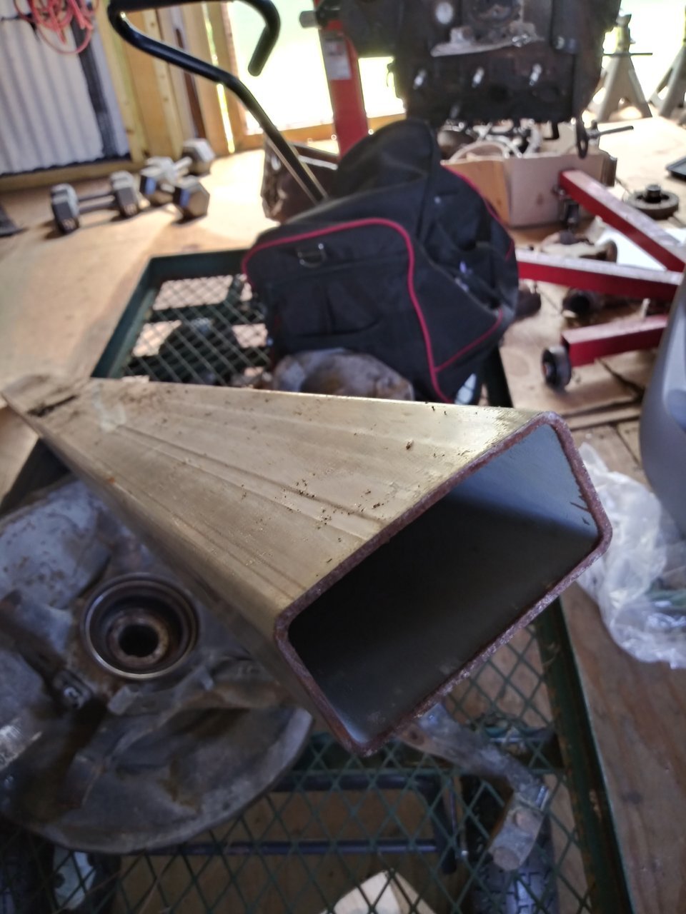

    Has anybody done their own spindle steering knuckle gusset yet? I guess I mean has anybody figured out how to make some on their own I have a lot a different angle, tube, and flat stock ..and time..now. if anyone has made their own please post a pic unless I have already missed one that somebody posted

    If you are going to make your own you should look at the available kits on the market (TC, Truck Shop, Dirt Kings, All-Pro, Baja Kits are the ones I know about) and base your design off them.
    With the cost of the available ones, $50-$120, I'm not sure there's very many people trying to DIY a kit.

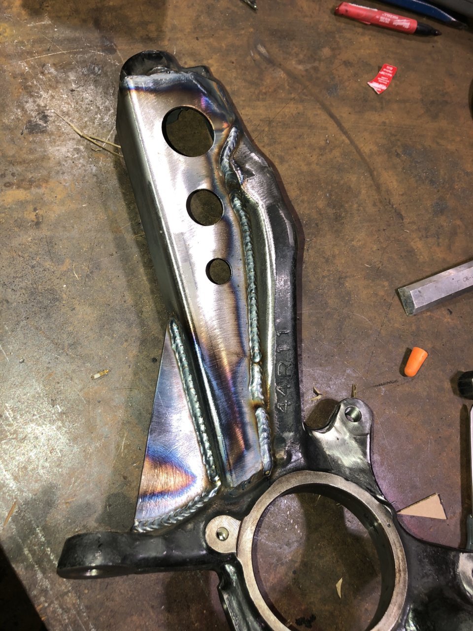

    I just did mine, I had the Total chaos swaybar version at first. Those cracked but only on the passenger side so I cut them off. Knuckles seemed to be pretty straight. I put a set of TC non sway bar on and modified them like glorifiedwelder did. They came out decent and now my tires have a little more room between the gussets which is what I was after.

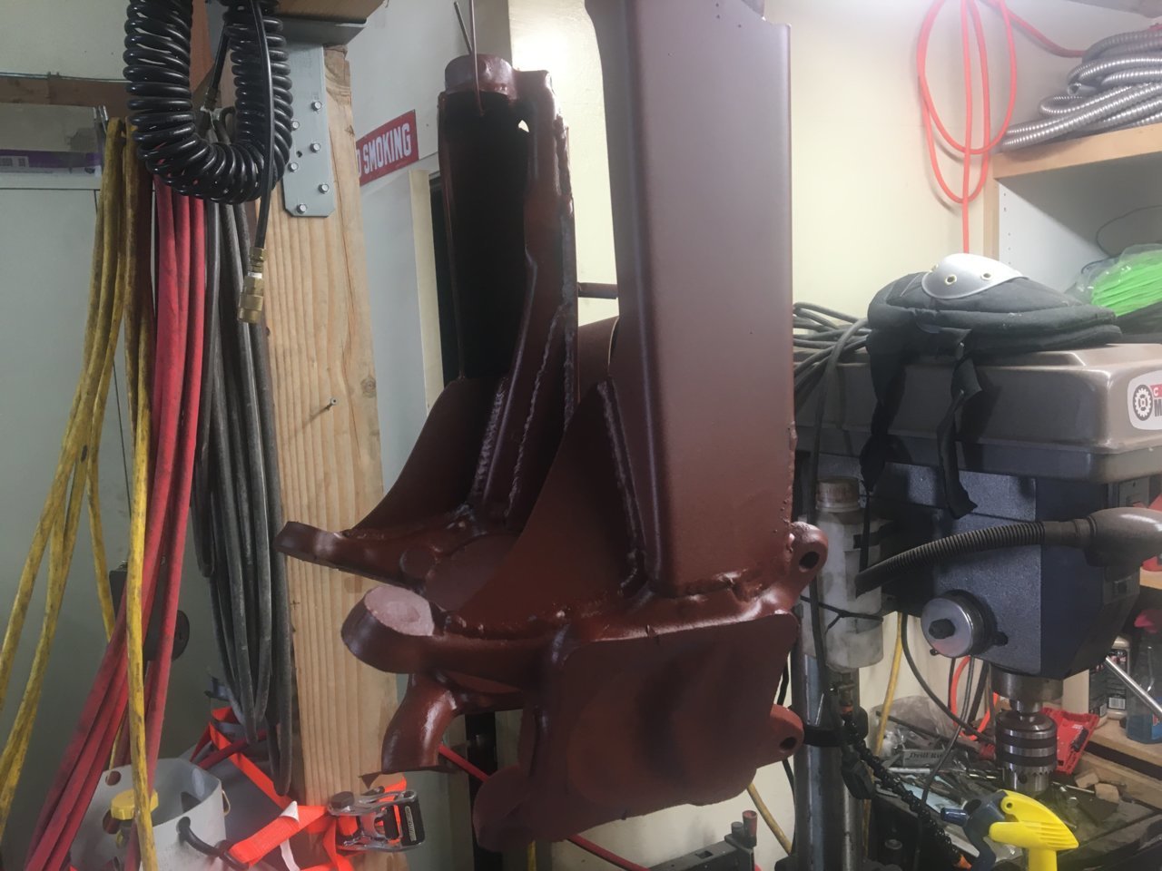

    #333
    Texoma
    Texoma IG: Triple C Chop Shop
    Feb 1, 2011
    #50374
    18,944
    Chris(Topher)
    Lago Vista, TX
    10 Taco 4x4
    A bunch a cool stickers, a bada ass MetalMiller Tx Longhorns grill emblem painted Hemi Orange, JBA long tube headers with o2 sims, Diff breather mod, Red LED interior lights, Fancy head unit that plays ipod n movies, Also DIY install factory stuff like, factory cruise control, factory intermittent wipers, OME nitro struts with 886x springs and toy tec top plate, JBA high caster UCA's for better alignmnet and dey beefier too, Old Man Emu Dakar leaf springs in da rear with the gear, U bolt flipper, Ivan Stewart TRD rims with 33" K Bro 2's, some bad ass weather tech floor liners so I don't muck up my interior, an ATO shackle flipper for mo travel in da rear wit the gear, also super shiny Fox 2.0 shocks back there too, all sorts of steal armor for bouncing off of the rocks like demello sliders, AP front skid, trans skid, n transfer skid, demello gas tank skid, and a tough as nails ARB bumper with warn 8k winch, I'm sure there's more
    TC has a seay bar version kit. I had the non sway bar version and bent them. Now I welded a set with the sway bar version.

    Torspd Custom Turbo kit [] Borg Warner 9180EFR Turbo [] Haltech Elite 2500 [] TiAL Q BOV [] TiAL V44 Wastegate @ 15psi [] CP Pistons [] CP Carrillo Rods [] ARP Head studs [] ARP Main Studs [] ARP Header - Head Studs [] Ported Heads w/ 1mm oversized valves intake/exhaust [] Brian Crower Forged Stroker Crank [] Darton M.I.D. Sleeved Block [] Kelford Camshafts [] Torspd 160* T-stat mod [] APR Large Fuel Rail [] Walbro 460 LPH E85 Fuel Pump [] FueLab FPR [] APR T56 Conversion Kit [] KP RACING Built T56 [] McLeod Racing Custom Twin Disk Clutch [] One Piece Aluminum Driveshaft [] MGW Shifter [] Custom lowering kit [] Ohlins Front Coilovers [] QA1rear shocks [] Custom Ron Davis Radiator [] Dual SPAL Electric Fans []
    Too bad the gusset material or the fabricated end product cannot be heat treated.

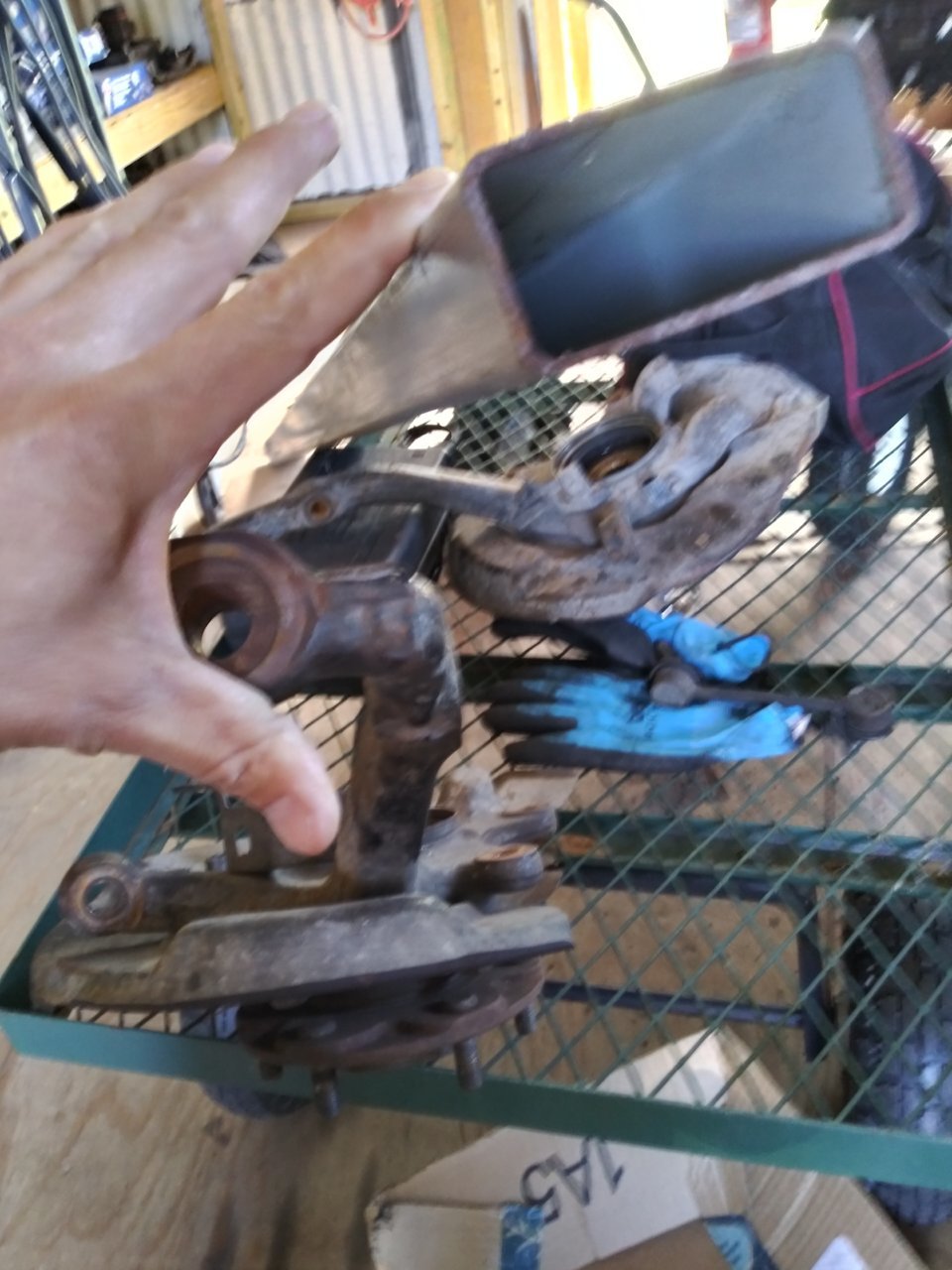

    20200427_121923_HDR.jpg I was thinking of taking some of this and trying to mock up a set.20200427_121946_HDR.jpg I would of20200427_121923_HDR.jpg 20200427_121946_HDR.jpg course see if I can find a set at the junkyard to practice on. I hope I get to go back to work soon so I can stop trying to find s*** to do.

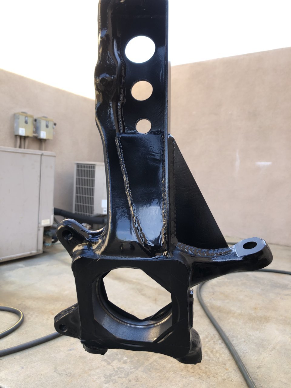

    I purchased the tc sway gussets. I’m wondering if it makes sense to add more gussets to them and fully box it in on the back side? And also fill in the gap around the unit bearing caliper bolt. I don’t plan on putting the sway back on it’s been off for 40,000 miles lol.

    The double shear gusseting has my attention.

    Off the top of my head I don't see an issue but I'd have to have a spindle in my hand to try to foresee any issues.
    Using the gussets as is should be more than enough for 99.99% of people. To crack those gussets you have to get out and offroad a lot and drive way faster than is safe.

    I only added one plate to the inside of spindle and placed a filler plate in the bottom corner of the outside of spindle. Not concerned about mud or water build up. I’ll clean it out after a messy trip. Time will tell...

    Is it just me, or am I the only one that would like to see the flat plate have dimple die holes in it?
