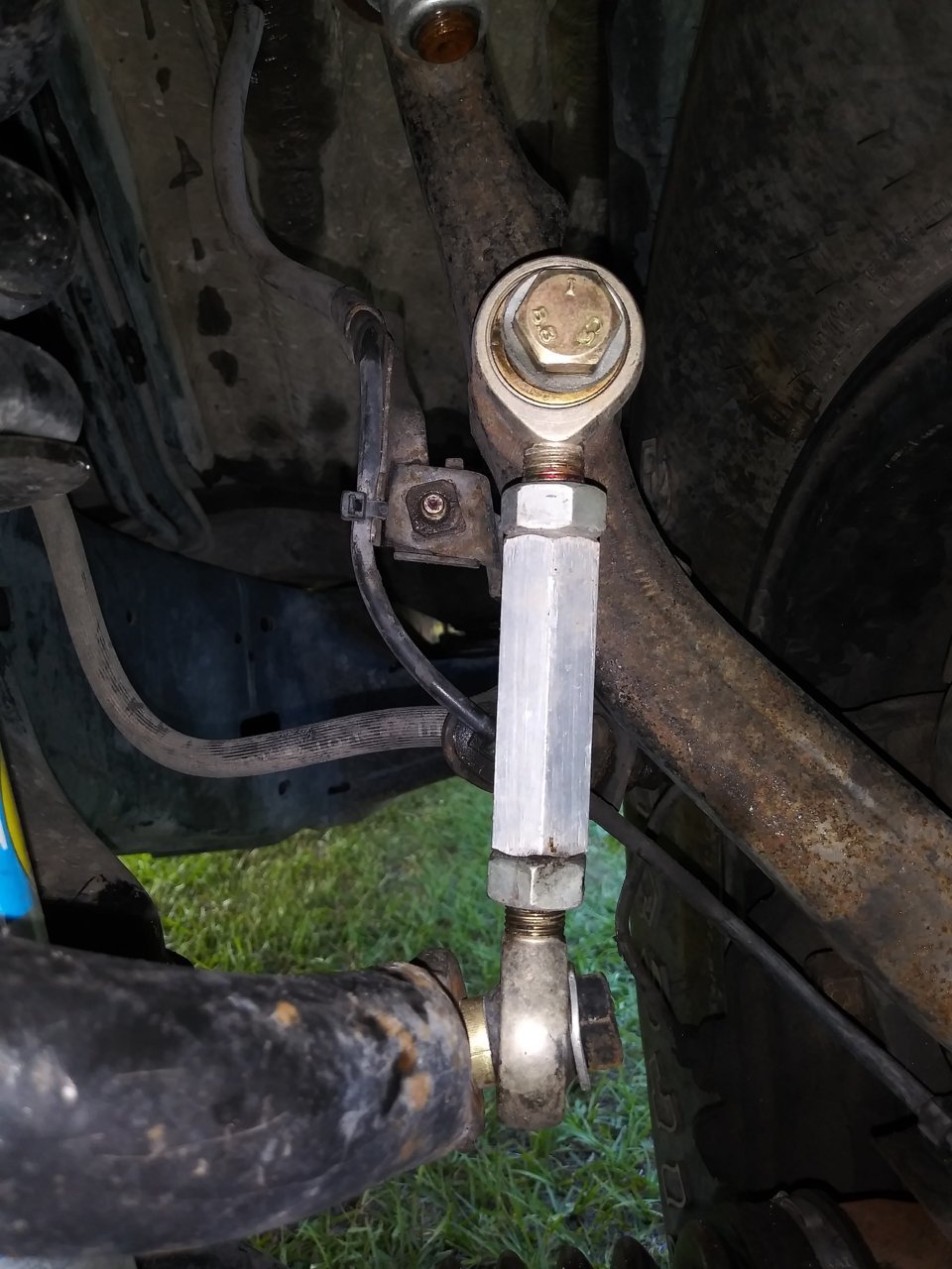

    Is this too severe of an angle on the sway bar end link? Should I get a spacer and try to bring the bolts more to Plumb ?20200517_155333.jpg but then it will be farther away from the contact point of the sway bar?

    It looks to me like if you put a very small spacer on the end with the washer(between the heim and washer) it would allow the heim to have a little more travel and possibly not bind, you would want the spacers OD to be the same size as the spacer you have between the heim and swaybar which would allow it to misalign a little more. Judging by the fact that the washer is bent I think the spacer you have between the swaybar and heim should be good enough.

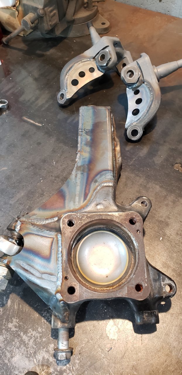

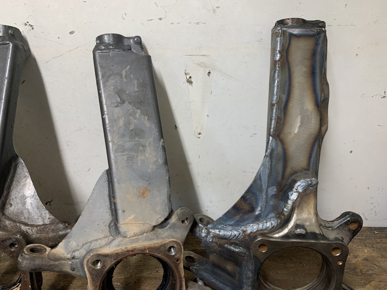

    More carnage, on to design #3 with the JD Fad ones. The old ones are bent ~3/8” from the hub mounting surface to the UCA bolt hole compared to the new ones.

    Wonder if they'll spring back, if you cut the gussets off? On the older ones.

    King/Dirt King
    Don't know, and not going to find out!

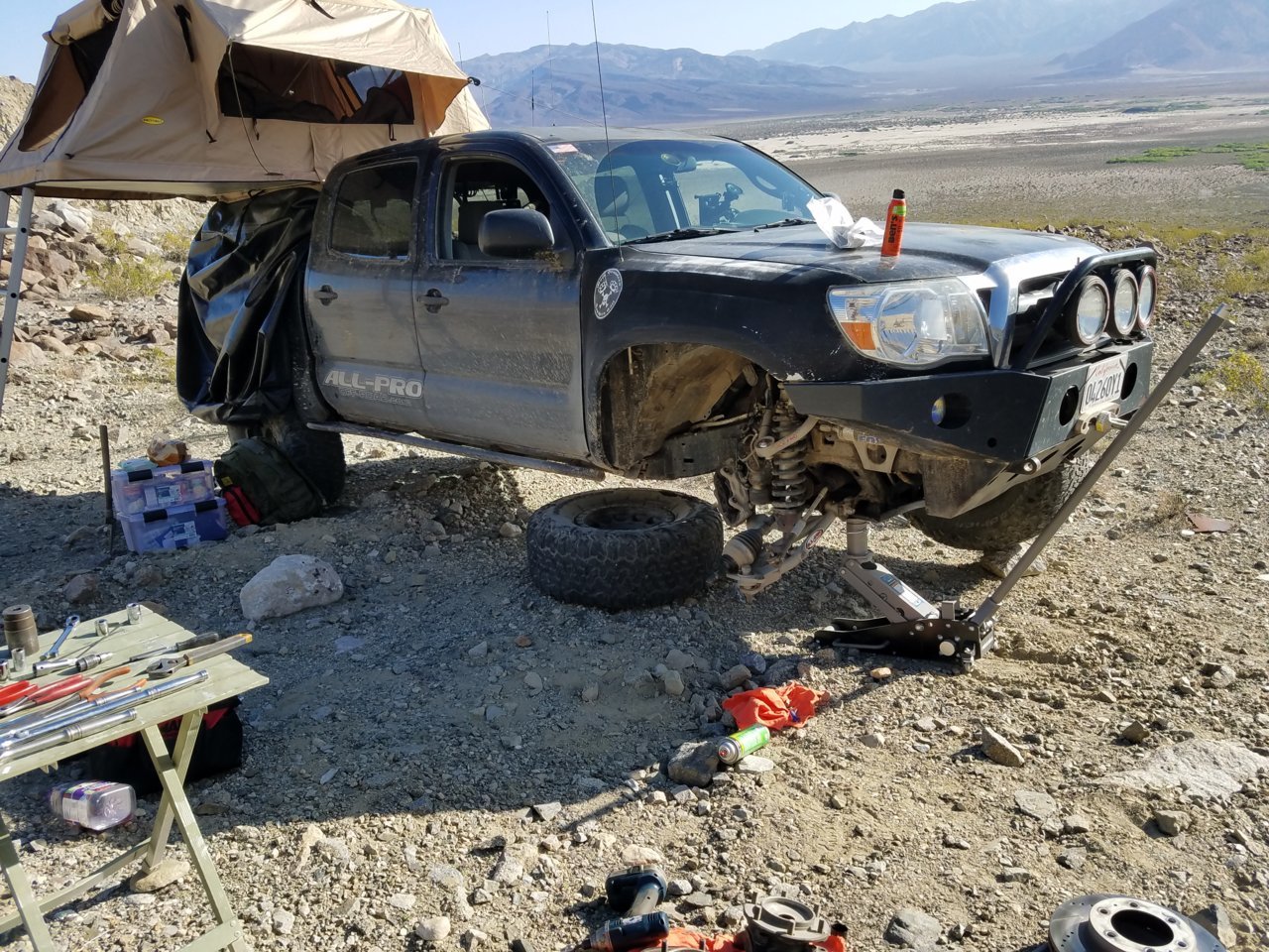

    My last failure was as close to catastrophic while in the middle of Death Valley..
