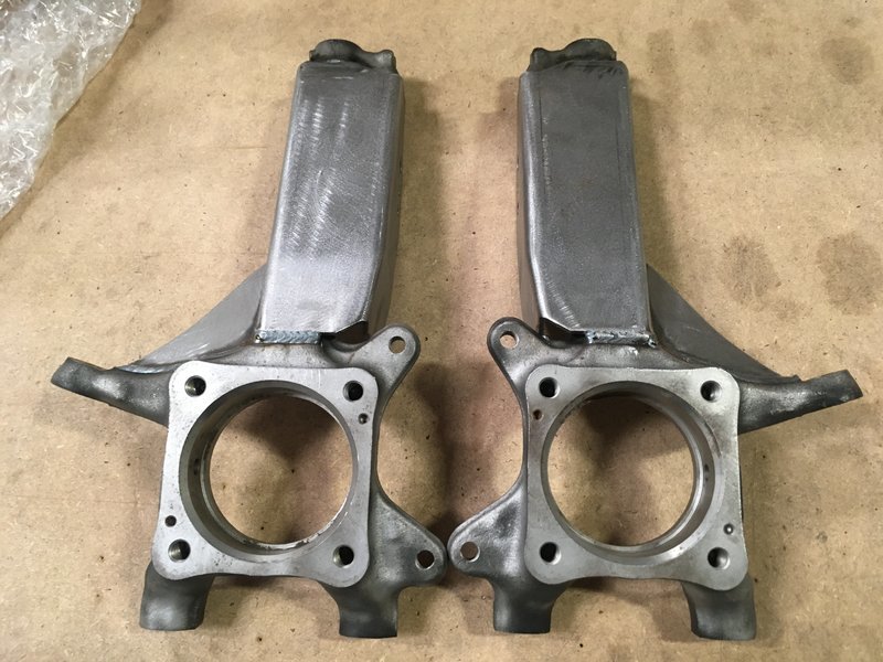

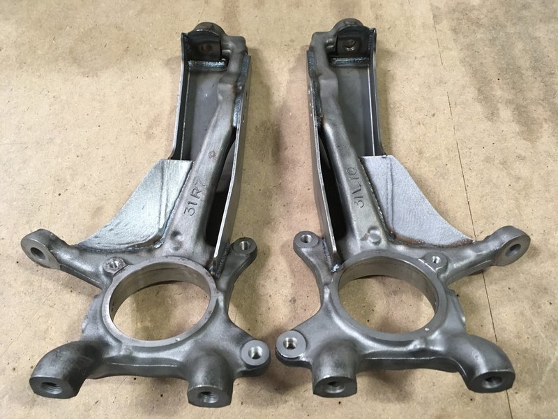

    All the cracks I'm see from the pictures posted aren't from lack of fusion, they appear to be from the gussets flexing at a different rate than the spindle, causing metal fatigue and cracking at the Haz. I personally wouldn't do the non sway bar gussets without adding a gusset from the gusset to the steering knuckle like this.
    And the more I look at it the more I'd like to see the steering gusset tied into the actual spindle itself and not just the gusset.

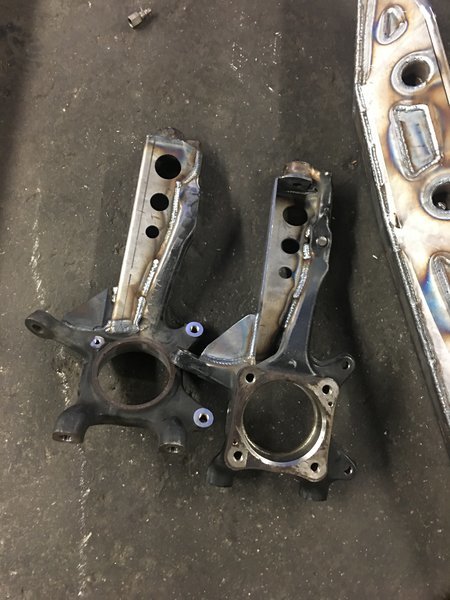

    I'm sure you know this having done a few sets yourself, but the TC swaybar version gussets do this. There is a gusset tying the knuckle to the main spindle, and then the main gusset ties into that.

    What I'd like to see is the Truck Shop ones with an added gusset for the steering knuckle.

    Yeah I generally try to push the sway bar version to my customers, only time the older version is utilized is if they specifically ask for it, plan to run stock wheels, and aren't willing to utilize a wheel spacer. The non-sway bar gussets weren't even something I felt like it was worth using until I started getting a bunch of members asking for them

    @jberry813 @glorifiedwelder Maybe I'm missing something.......Is there any benefit to having the steering extension on the gusset other than having a longer base for the gusset to be welded onto the spindle? It seems like "The Truck Stop" style would be plenty beefy even without the steering extension.

    I don't see any benefit to not having the steering gussets

    Not really. As you stated, just a nice wide weld at the base/hub to help counter the flexing. You'd have to take a really hard fucking hit with the tire turned to bend/break that tie rod ear since the rack is on the front of our trucks.

    X3, these with a gusset to the steering arm would be beef. Does The Truck Shop sell the gussets as a part, or just as a welded kit?
