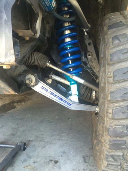

    I can tell you from experience, James was able to deliver on his one day turnaround promise.
    Brought my '09 spindles into shop in a cardboard box, picked them up the next day all beefed up.
    :thumbsup:
    @lembowski 's spindle
    Good on raising awareness @MonkeyProof :thumbsup:

    IMO, the truck shop gussets follow the contour of the spindle quite well, so I think you could possibly even run OE wheels with 5.25 BS, but that's a guess on my part!!!
    I'm running 4runner limited wheels, 4.5 BS

    I was never quoted BS limitations, if there are any, they should tell, but I wouldn't be surprised if they didn't know! Exact same issue I had with the Total Chaos ones. TC couldn't say, even when I created a really good thread about it, no definitive answer.
    Anyway, here are better pics I have that show the contour.
    I'm running these with a UBJ too.
