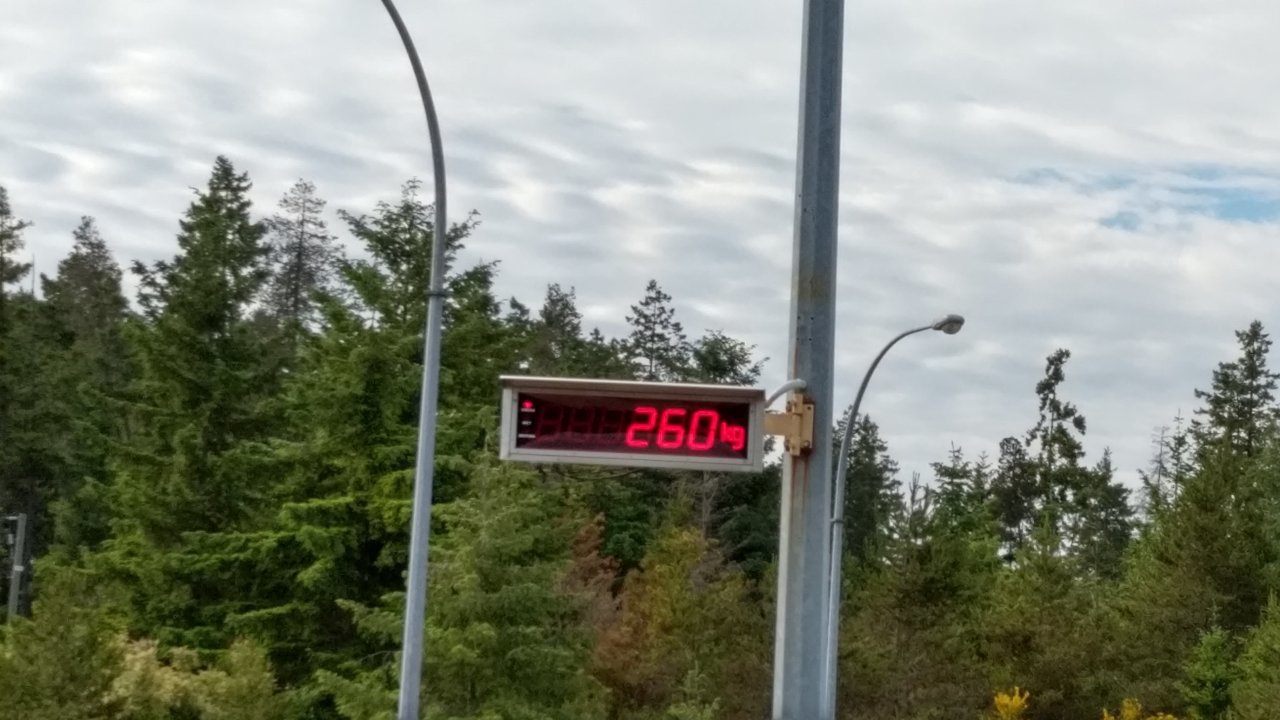

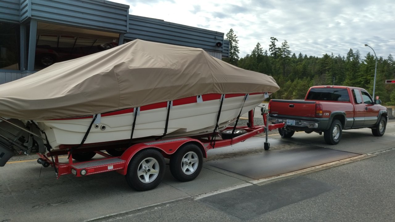

    I took my boat to the local weigh scales and dropped the tongue on the scales, worked great and free too!
