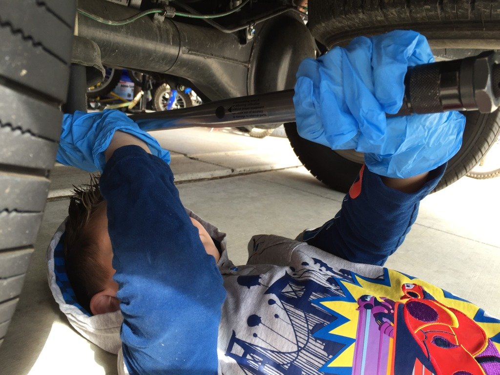

    Huge thanks to splitbolt and TW. Did mine today and found more of the same... 7 of 8 needed to be brought up to 52 foot pounds. Loosened and re-torqued the 8th one for good measure.
    If you haven't checked yours yet, do it. It's so easy my six year old helped out.
