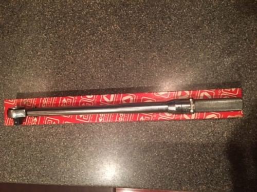

    Standard torque for Tacoma rear ends is 89/90 ft lbs. I believe your 37 lbs under torqued. I checked mine the other day with just over 3k on my rig and was 15 lbs light.
    Hope you got a good one those cheap Harbor freight ones are crap. Get a good one with a locking ring and clicks when you hit your mark. Still using my Utica wrench I bought back in the 80's.
    Here is one from ebay like mine, vintage re calibrated from Utica says the listing.
    https://www.ebay.com/itm/Torque-Wre...882653&hash=item285520bcd1:g:awgAAOSw5ipasTTX

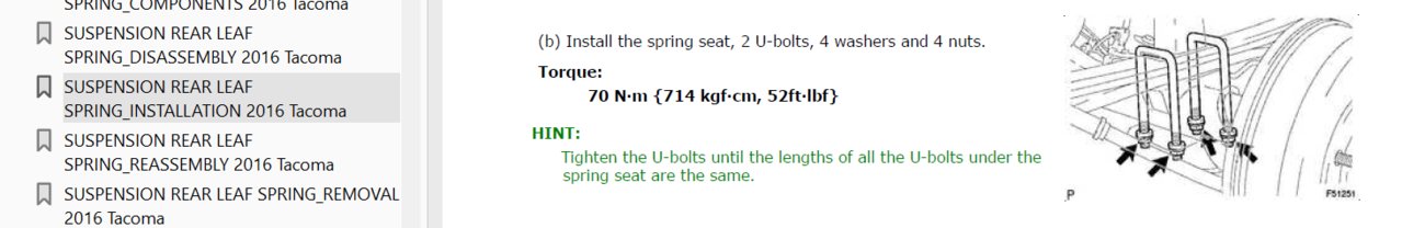

    Where are you seeing 90 ft lbs? Everything I've seen in this thread has been referring to 52 ft lbs. I think someone even posted the service manual that stated 52 ft lbs.

    Seems like the the varying torque spec is coming from diff Gens of Tacos. Also some going by various bolt grades and thread pitch. I have seen 52 ft lbs for 3rd gen U bolts from what I've researched as well.

    Haynes Repair Manual #92076 for early 4x4 tacos 90 ft lbs. The size of the ubolt and nut on our rigs are pretty thick 19mm or 3/4 inch nuts can easily handle it. I wasn't comfortable at 52 so went with my gut feeling and set it to 89 seems standard on most rear ends.
