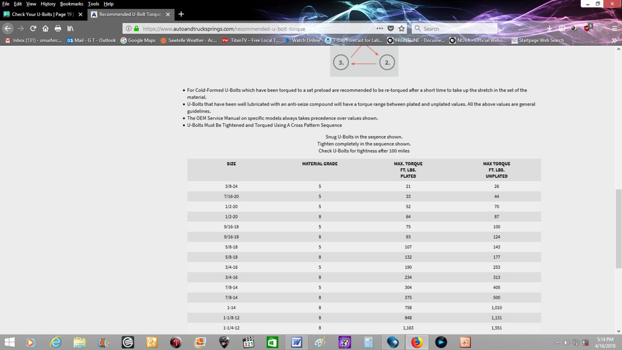

    Well after researching the torque values of u-bolts I found some specs.
    To help determine the diameter of your present u-bolts, please refer to the following chart
    • 11/16 Socket = 7/16 Rod
    • 3/4 Socket = 1/2 Rod
    • 13/16, 7/8 or 21mm Socket = 9/16 Rod
    • 15/16 Socket = 5/8 Rod
    • 1-1/16 or 1-1/8 Socket - 3/4 Rod
    • 1-5/16 Socket = 7/8 Rod
    So my bolts are grade 5, unplated 3/4 nut 1/2-20 so I backed it off to 72 ft lbs. I just don't trust the OEM spec since Toyota already screwed that pooch.
