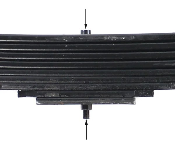

    does anyone know if these leafs are keyed to a centerpoint on the axle? im wondering if the axle could "drift" out of center or off caster from hard bumpy trail use?
  17. Sep 30, 2021 at 1:22 PM
    #397
    DaveInDenver
    DaveInDenver Not Actually in Denver
    May 18, 2013
    #104390
    3,619
    David
    Grand Junction
    2008 Super White TRDOR AC 6MT
    Unexceptional
    Yes, of course they're "keyed" using the same technique that Moses used when he was still just an engineering intern - the spring pack center pin.
    The pin is slightly smaller than the hole in the axle perch, so your axle can walk around a little bit but unless this pin shears or you leave the u-bolts nuts loosened about an inch from touching the axle can only move so far.
    But even though it's not necessarily deadly the little of movement with under torqued bolts can cause problems like shaking and clunking. The pin is also not that stout (basically a 3/8" fine thread bolt with a smooth head) so if the u-bolts are loose enough the movement could cause it to shear eventually.
