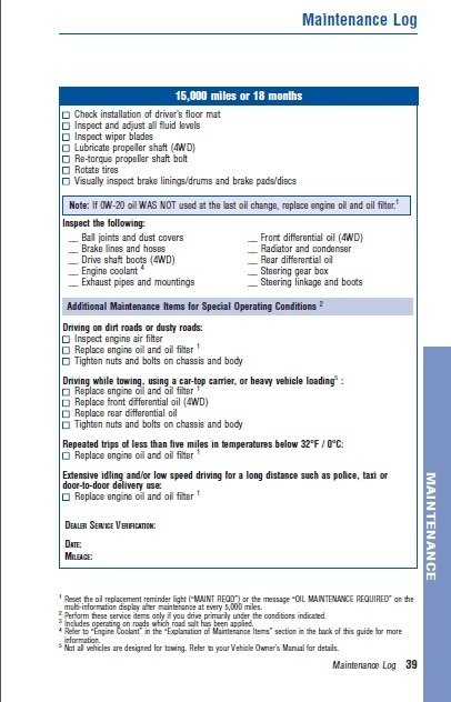

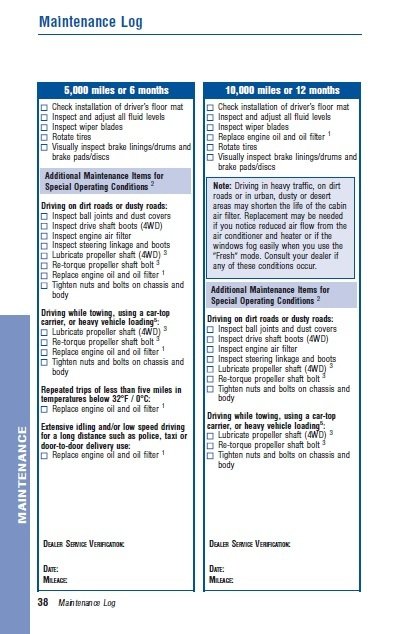

    Could try torquing them; it's part of the 5,000 mile special condition maintenance.

    I keep seeing this "special condition maintenance" thing - what qualifies you for that?

    It varies; it's in the Maintenance Manual.
    Toyotacare does not cover it.
