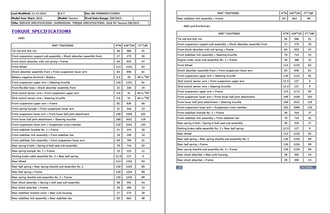

    According to this excerpt from the service manual, it is 52 ft/lbs for the 2WD and 37 ft/lbs for the 4WD and Prerunner. I can't explain why the difference.

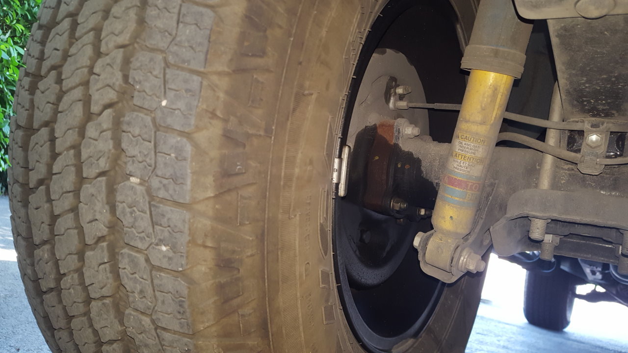

    Checked mine today, they were a bit loose and also found this.

    hope its just a brake cylinder, not the other axle seals

    It's the axle most likely. Both sides and the diff cover leaking. And it whines.

    wow was the differential overilled with gear oil, pretty tough to blow all them seals out
