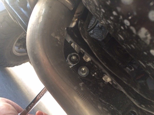

    If it's the #2 zerk, I had to take out that heat shield, secured with 2 12mm bolts.

    I thought i established it wasnt the second zerk... and yes i too took off the heat shield for the second zerk.

    I just did mine and, like you, I heard the air gurgling sound on at least one of the 5 zerk grease points. I could only get to 4/5 of them. The front one was too tight of a fit for my grease gun tip. Luckily, it was the only one that looked like it had been hit with grease. The rear-most u joint zerk had been painted completely over with black paint. Also, for those who are trying this yourself, I have included a photo of the shield that has to be removed for access to one of the zerks.
